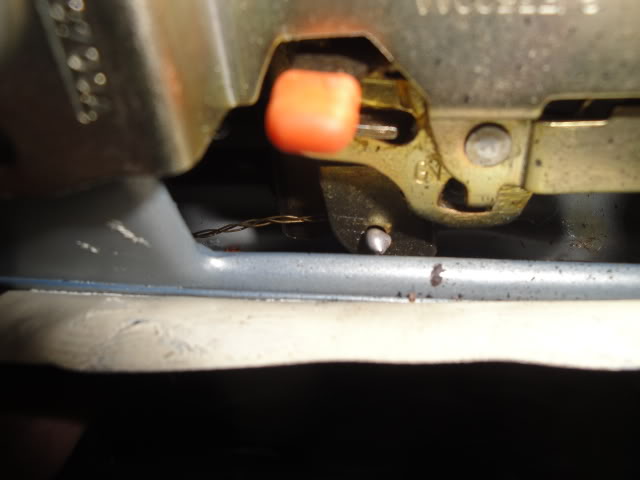

An important point is to note is that orange plastic capped lever - while it's Up, all is well, but if you inadvertently push it Down and leave it in that position, the boot lock becomes inoperable by the fob, the key or the boot lid button - you've been warned!!
Now look below the orange cap and there's a vertical lever - not the horizontal one! - with a small hole in it. That is the bit we need to be able to move from outside.

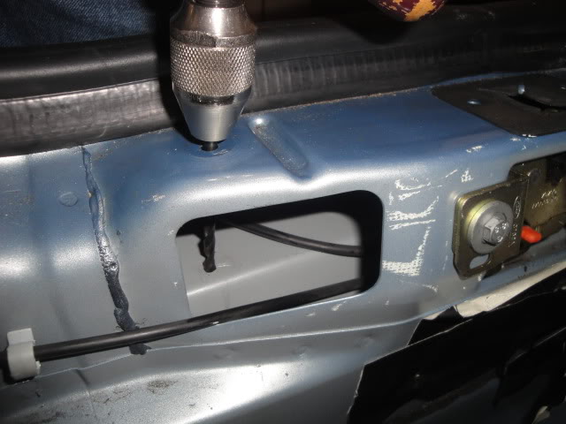

My approach is to start by drilling a hole as shown in this photo, using the fir tree clip hole already present in the top surface as guide for the drill.

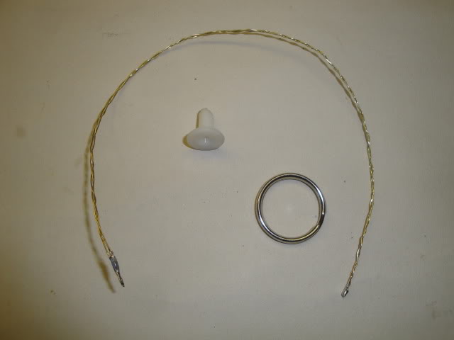

I then raided the come-in-handy box of plastic oddments to find a suitable bush to suit my 5mm hole - size is not critical! - and added it to my other necessary parts shown here - -

That's a split ring, a length - about 300mm - of flexible wire, (or string!) and the bush - again not actually essential!
The wire needs to have some sort of 'stopper' on its end; I used a tight loop filled with solder, but a knot in the piece of string would do, as you'll see soon!

Now pass the wire/string through the hole in that vertical lever:

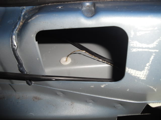

Then through the bush:
And then, from underneath, attach the split ring - or whatever you fancy! - and the job is done.
