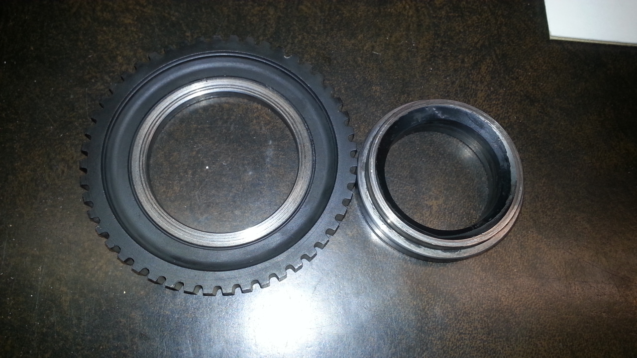

Update:
hi guys...thank you for all the inputs....after all the dances and nervousness it turned out to be the reluctor ring for...it was split (see picture)..... I dodged the bullet this time....thank's again.
PROBLEM SOLVED
Attached Thumbnails emergency help!!! cruise not available, transmission fault-20150619_164455.jpg

Glad to hear it was something "simple". Have you managed to locate a replacement, or are you going to repair it? Thanks for the opportunity to learn something new!
The jaguar specialist Indy shop has one used ...so they fix it ($398)...now my car runs like Jaguar should again.... it's a win for me.
