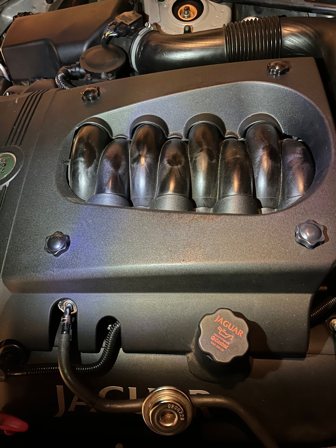

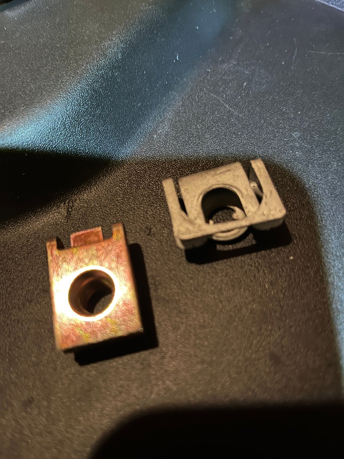

I found the perfect replacement for anyone missing an engine cover screw or two.
amavoler Theft Deterrent...
Amazon Amazon
These are used to secure a saddle bag on to a motorcycle, but the size is perfect for our use. All you have to do is slide off the hardware on the mounts with a flat head screwdriver and slide on the new mounts in their place. The thumb screws fit in the existing cover holes and secure tightly.
Original mount clip on the right. New mount clip on the left.
New mount clips slides in perfectly.
I’ve only had my kitty for a few weeks, so my excitement is probably more than others. Just glad I’m contributing to this forum.
