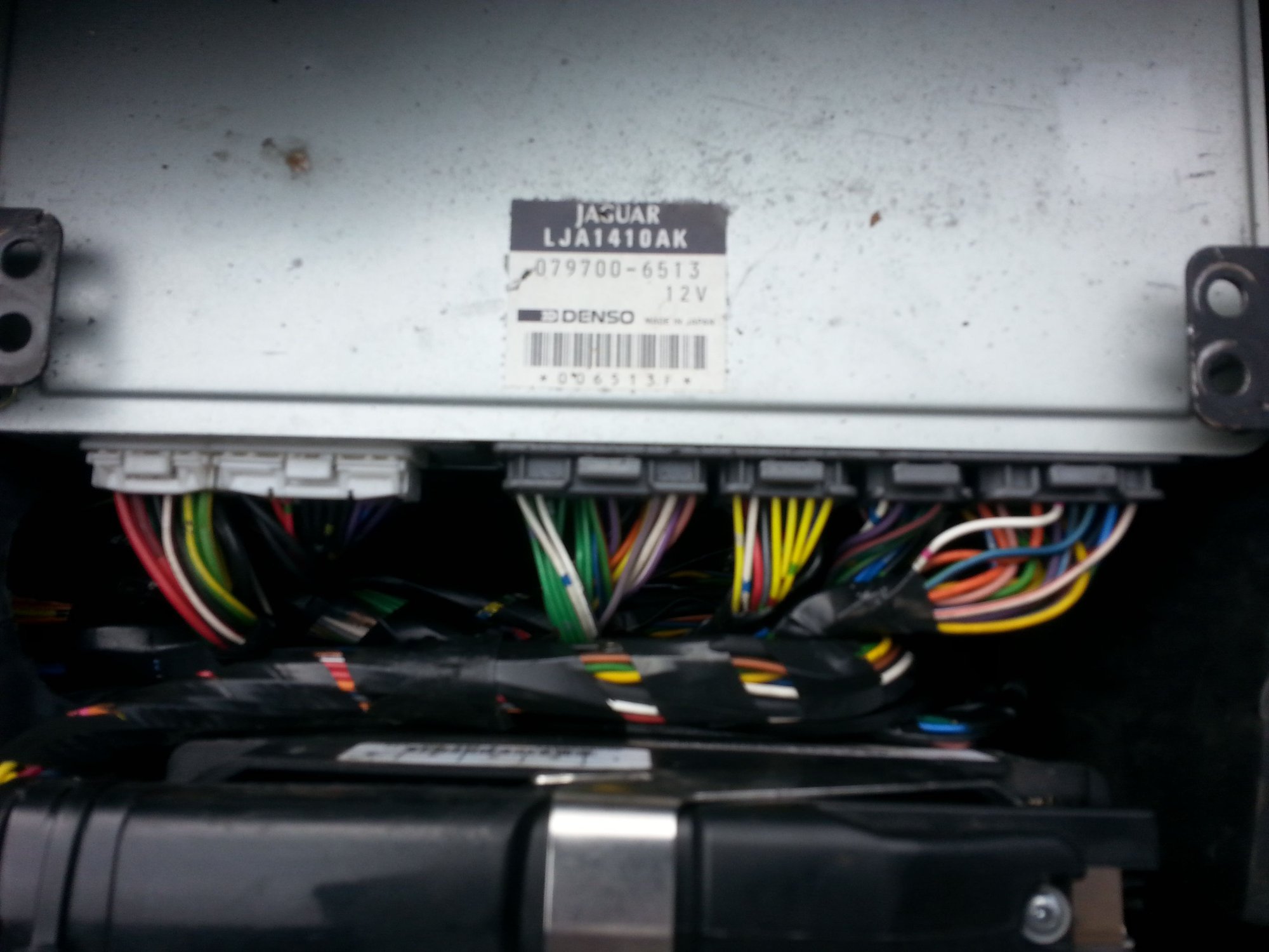

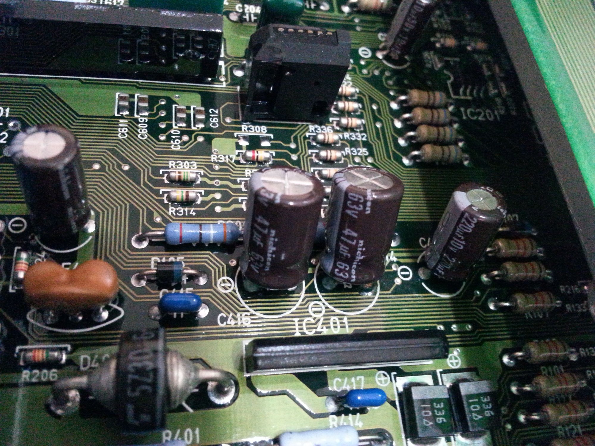

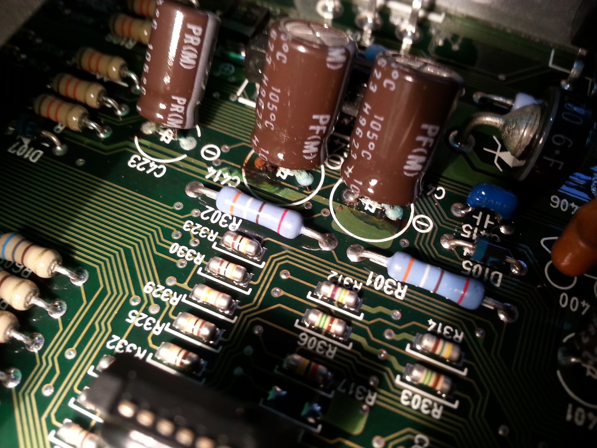

**** FIXED ****
Hi, Thanks to all, your replies were spot on, after further investigation on ECU/ECM issues on internet I found that this is indeed a common problem with this XK8 of this age and that the issue is due to old capacitors which leak and corrode circuits paths.
So I removed the ECU and opened it up and found exactly that. There are 7 electrolytic capacitors of which 4 were leaking.
Armed with a soldering iron, I removed the offending capacitors (including the one not leaking as a precaution) and replaced with new ones from Makro (£2.68 in total).
The capacitors were all located in places well away from sensitive IC chips, so little risk of overheating components with the soldering iron, Still I took my time, very carefully taking nearly 3 hours to change 7 capacitors, making sure I did not drop solder anywhere or overheat the board.
Seem to have caught it in time, very little damage to circuit paths, easy to clean.
Put it back in the car today and....... it worked, the fault has disappeared and he car is driving normally (seems smoother as well)
Only done about 20 miles, but the problem used to re-appear within 2-3 miles of clearing the codes - so I'm very hopeful that it's fixed permanently.
Again thanks for your advice - perfect!
Tony.

Thank you for some excellent information. Should you by any chance have the numbers (values) of the capacitors needed?
Best rgs.
Oyster
Old Sep 30, 2017 | 06:45 AM
tonyforman's Avatar
Joined: Jun 2015
Posts: 22
Likes: 13
From: Middlesbrough, North East England
Hi,
Yes, Capacitors specs are as follows:-
1 x 560uf, 50V, 105°C
2 x 47uf, 63V, 105°C
2 x 220uf 10V, 105°C
2 x 10uf, 50V, 105°C
By the way, still running without issue 2 weeks on and 300 miles.
Also noted that poor hot engine starting issue has gone away also.
Used to have to start using throttle when hot, (took some cranking)(fine when cold)
Now it starts when hot perfectly.
Tony.
