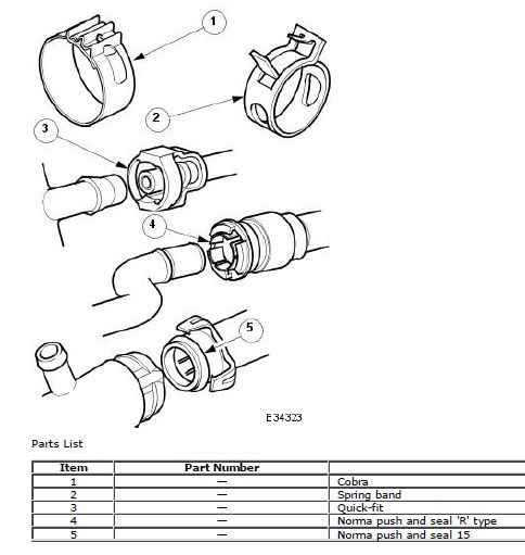

Another question ... the shop manual shows five clamp types, but doesn't describe the proper method for removal. The spring clamp is obvious, and I have special pliers for those. But how does the cobra clamp work? And do the others have a sliding sleeve or do you squeeze something?
Attached Thumbnails engine had a fluid leaks sometime in it's past ...-hose-clamps.jpg

There is a special tool for the cobra style although it can be done with pliers. Essentially there is a small hook stamped into the metal and you squeeze the outside two ridges until it unlatches.
#2 you know.
The others are variations on the o-ring seal types. Push to connect, squeeze the sides to release and pull apart similar to the electrical connectors.
