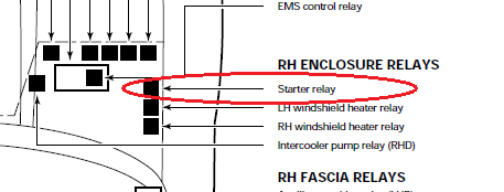

You can pull the starter relay under the false bulkhead cover:
..to eliminate the electronics, but could be a sticking starter pinion if it is indeed staying engaged?
Note it won't start off the key while the relay is unplugged.
