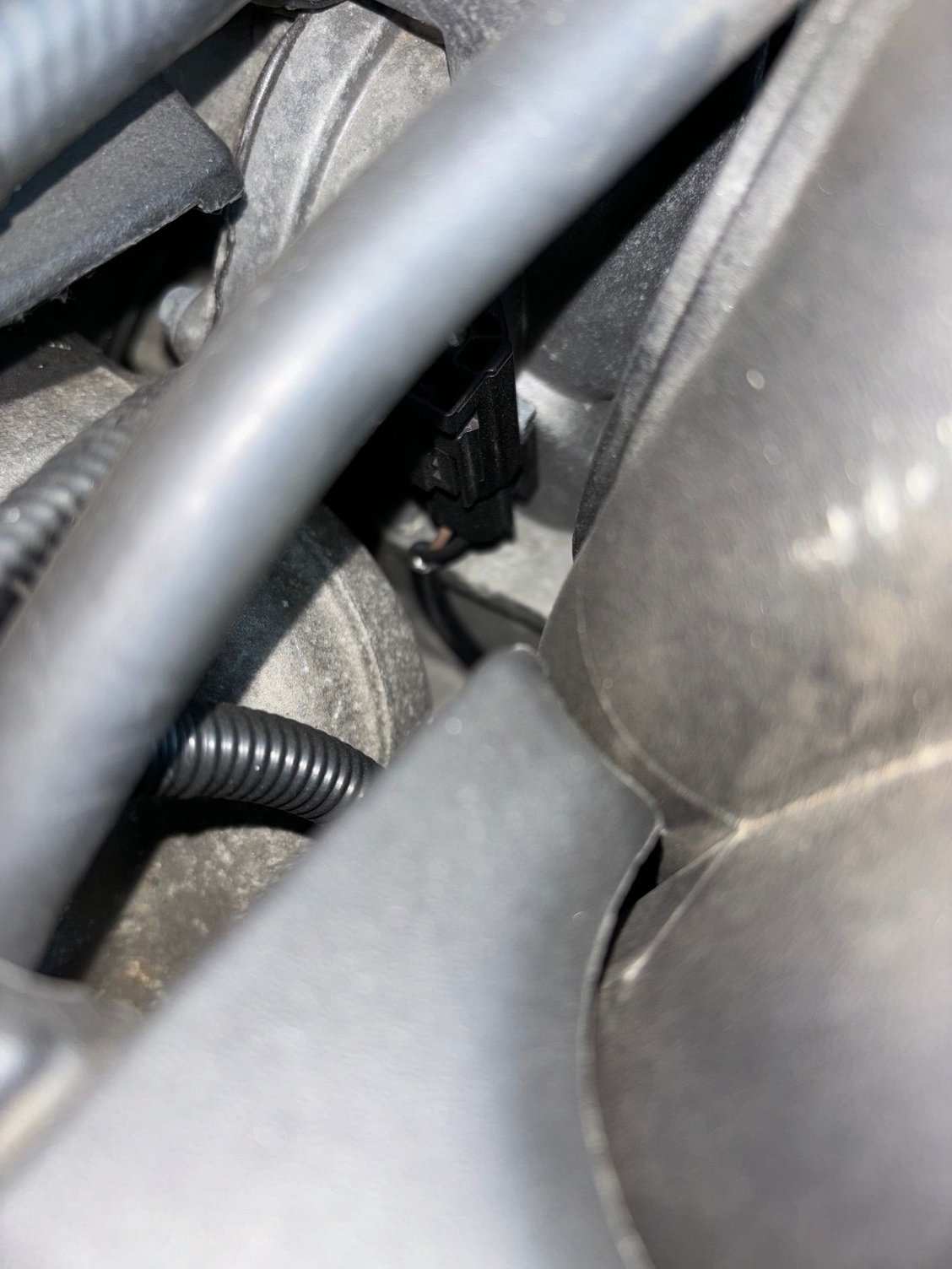

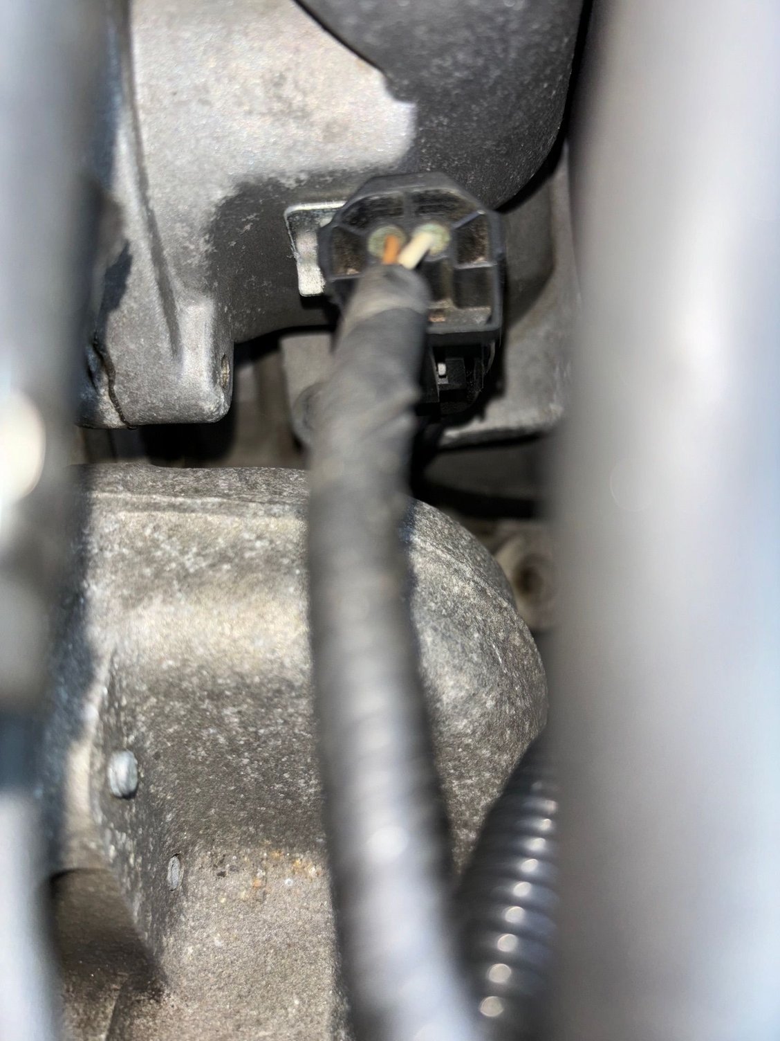

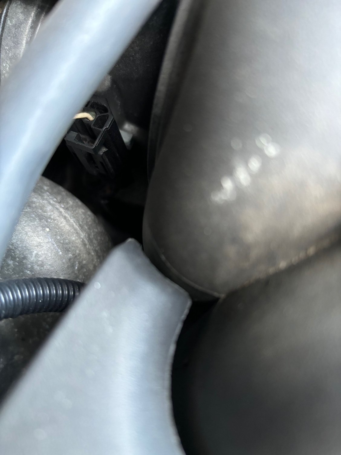

It looks like there is no number at the top of the engine. If I'm reading the other post correctly that would mean that this is the later version of the engine, with the number stamped in the side of the engine, and was built with the metal version of the tensioners.

I think it’s worth a look to visually see the parts in question.
My 2002 XKR was build after the date the tensioners were supposed to be the safe ones. But they failed the previous owner and cost him thousands to have repaired.
No engine number or reference date is 100% accurate in my view. There will always be anomalies in the manufacturing process.

You're probably right. As soon as I get a spare hour or so I'll order a set of gaskets for the covers. I'll pull one and take a look to confirm what is in there. Who would have thought there would be inaccurate information on the old Interweb!!! I'm shocked!!
