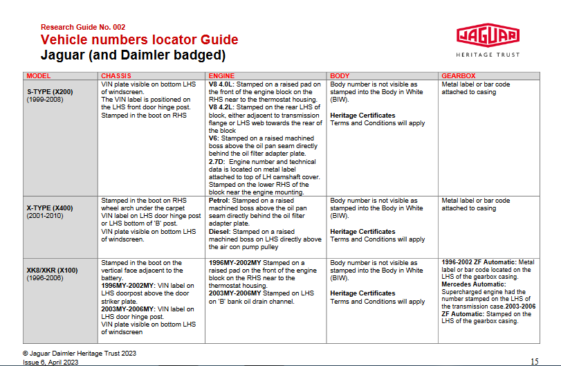

Here's a snip from Heritage's own guide pulled from the website, for heavens sake...

Yes, I have their guide and reviewed it with the woman. She insists that the engine number starts with "PA" and the build number is not the engine number.
I am at a loss. They will not provide a certificate without the required numbers (VIN, Engine, Transmission), and photo of the title. I have given them everything except the engine number they are asking for.

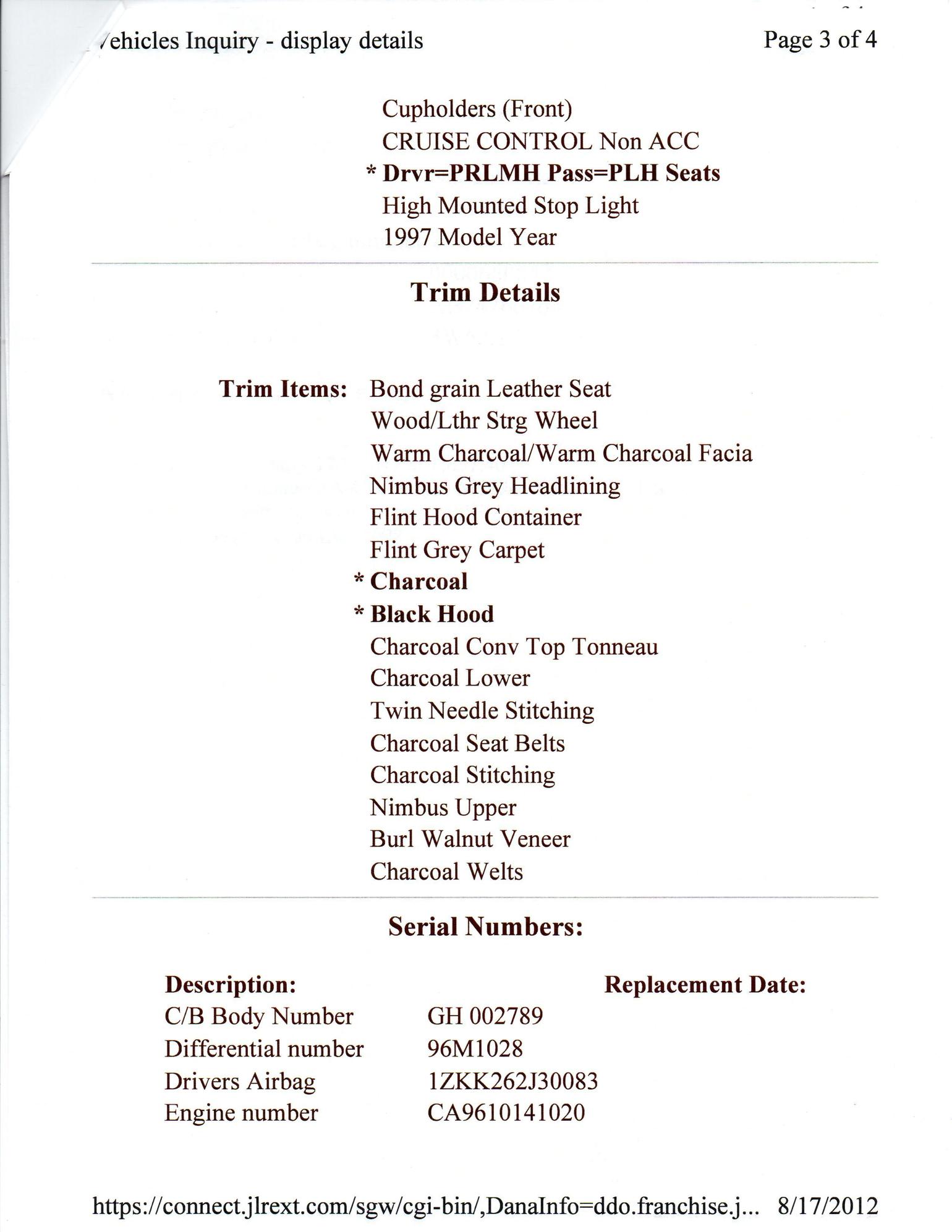

I got the engine number from a dealer inquiry scan in 2012.
Presumably a CA prefix rather than a PA in this case, then 1996 October 14th, 10:20.
Definitely the engine number so if you you have no prefix before the 10 digits, rather than PA or CA, then it's clearly not needed.
Richard
