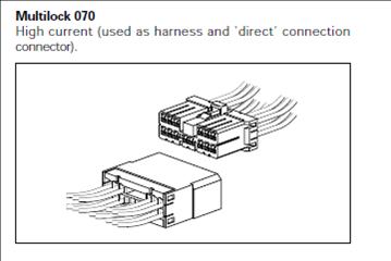

I didn't recommend a reset, I think your ignition switch is bad. Somewhere in the steering column, you'll find a connector like this; [IMG][/IMG]
Check for continuity between the white wire with a blue stripe, and the black with pink stripe wire. That's the suspect position II contact, seen here-
If you don't have a meter, connect a wire between the white/blue wire and a good ground on the car somewhere. If that turns on your instrument lights, then guaranteed it's the switch..Even a paper clip between the two pins in the connector will work.
