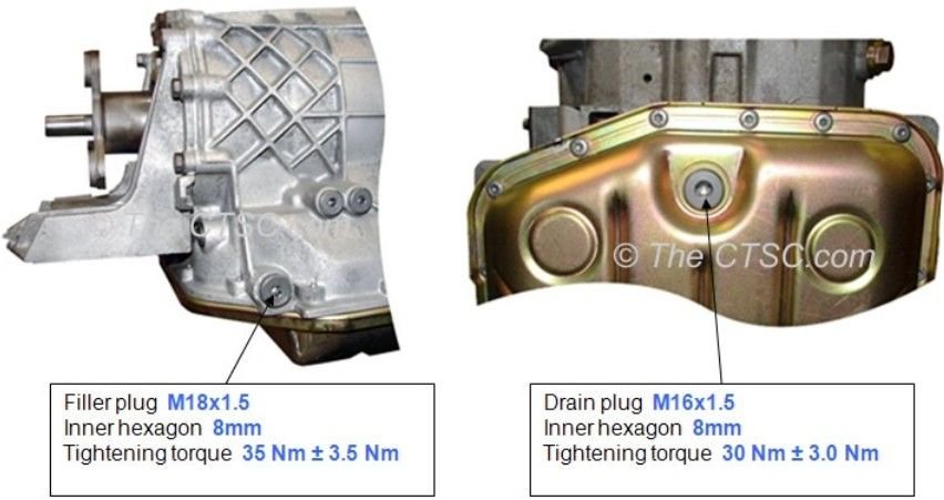

For the avoidance of doubt, here's a snip I borrowed from the CTSC:
It's strategically located near the exhaust so as to keep your hands warm during the fill process

Originally Posted by brinny
dont think the 5 speed does. 6 speed does but its an 02 car, dont think thats 4.2.
The 5 speed, 6 speed and 8 speed ZF gearboxes all have fill / level plugs as I know from draining and filling all of them.
Well if you try a 99 4.0 you will need to use the dipstick tube .
Are you referring to the Mercedes gearbox rather than the ZF gearbox? All the XK8 models of any year and engine size use a ZF box.
Which box, which model car? That int a 99 xkr box for the avoidance of doubt michael.
No, it's a ZF 5HP24 transmission, brinny, which is what the dialogue is about & the OP has in his 2002 XK8...
