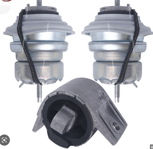

Originally Posted by jahummer
Also transmission mount.
I've already replace the engine ./ transmission mounts.
the 3x mounts in the image were changed.. is there another one?
Attached Thumbnails Might have damaged my gearbox (returning junk my wife bought in IKEA) - HELP?-screenshot-2023-01-17-23.06.43.png
