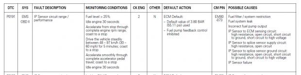

In 2003 electronic fuel pressure monitoring was added to the XK. P0191 is a fuel pressure fault. It can be as simple as a clogged fuel filter or an o-ring, or as difficult as a fuel pump requiring tank removal. Or it could be the sensor itself. See the chart below:
