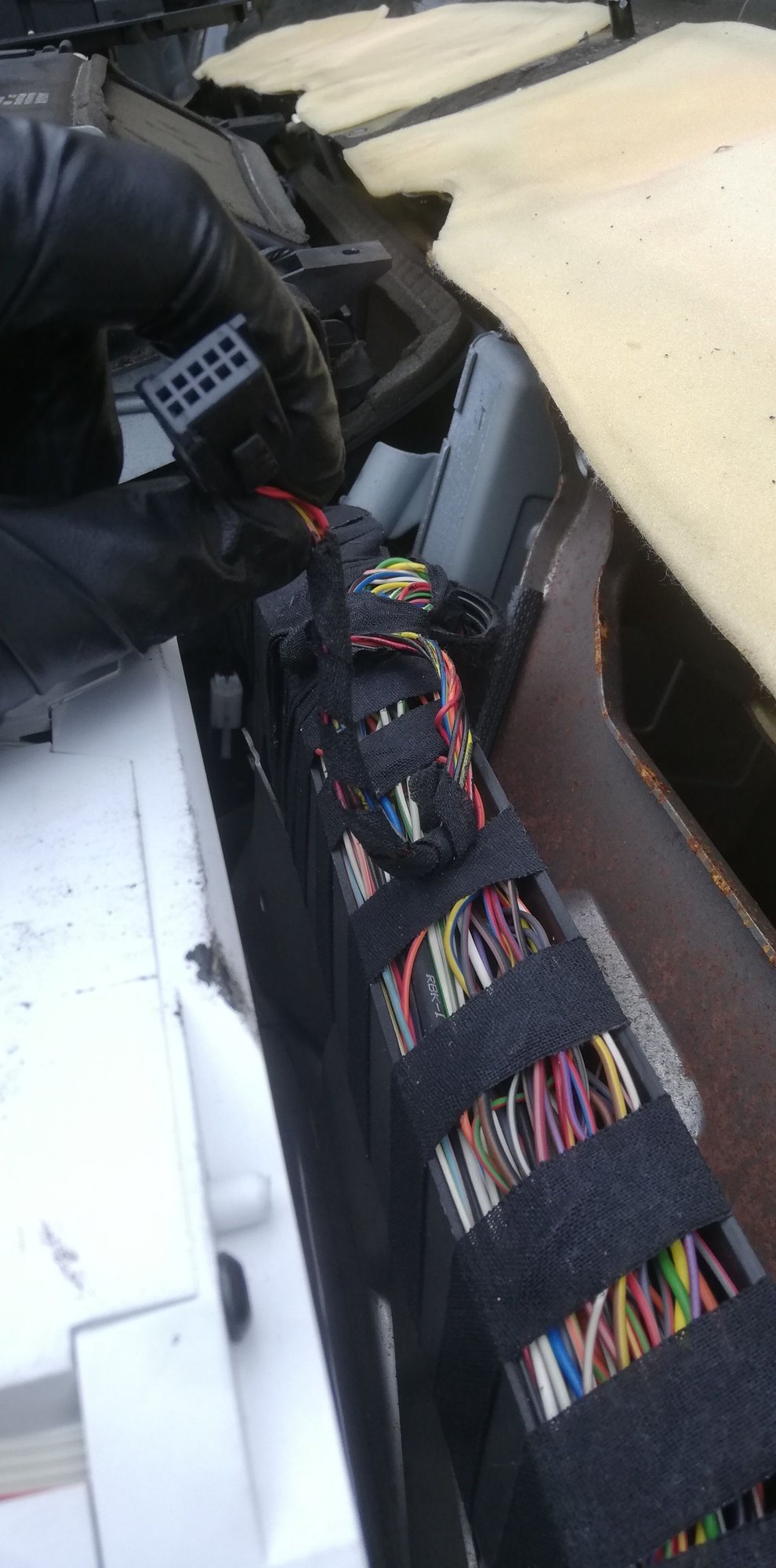

This is the only wire that I can see that doesn't not seem to have a place to go, I don't remember touching it to begin with... But who knows.
Old Apr 1, 2020 | 11:11 AM
XK Owen's Avatar
Joined: Aug 2019
Posts: 182
Likes: 60
From: Halstead
Is the other end connected to the obd port lol
