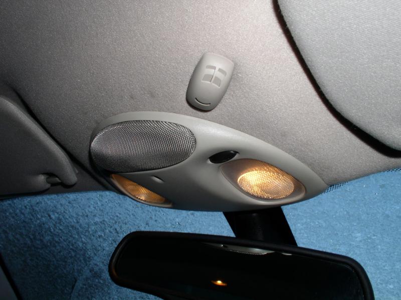

Just out of curiosity, where is the factory microphone located? I have never seen how or where the factory microphone was installed (a photo would be great). All XKs were pre-wired for a phone but it was for a specific type of Motorola phone that is no longer available. Also, for cars that did not opt for a factory phone, the wires were never connected to either speakers or microphone, unfortunately. I have a 2002 X-Type Jag and, unlike my 2002 XKR, it has very nice factory microphones pre-installed, to which after market phone systems can be easily connected.

Can you post a photo of what the stock microphone looks like and where it's located? Also, do you know what year Bluetooth became an option?

Hi Mark The microphone is next to the drivers sunvisor and the interior light console
Al
Old Dec 15, 2011 | 03:29 AM
Mark,
Its next to the roof console.

I remember a friend having a late 2002 XJ8 with bluetooth but this used a Jaguar branded Motorola bluetooth flip phone. It was likely to be 2003 when Jaguar introduced true bluetooth capability. Some might argue they haven't done this yet!
