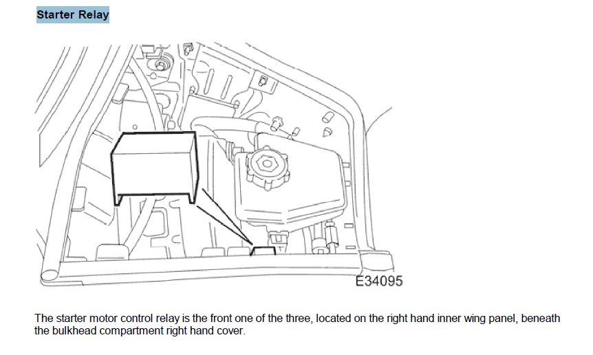

He believes it is good, or did he load test it and it checks out good. The Jaguar will not crank when battery voltage is less than 11.5 volts. Normal is 12.5 to 13 and charging is 13.5 to 14.5.
To answer your question: The starter solenoid is part of the starter and not stand alone. In order to handle the amperage required for starting the system uses a starter relay.
If you know the battery is up to par then swap out a like relay for the starter relay and see if it will crank. If it cranks the relay is bad.

There will be more then one relay click on key rotation on the X100 and the specific one to put your finger on to feel it is the starter relay .
