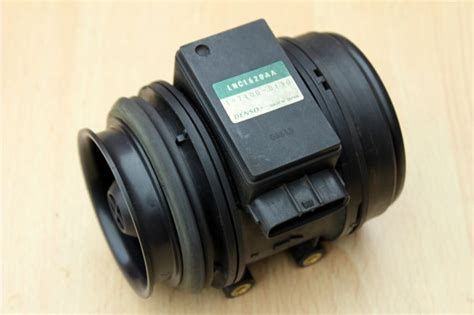

There's a thread here from kreysig which may help about RP with no codes:
https://www.jaguarforums.com/forum/xk8-xkr-x100-17/restricted-performance-but-no-code-113854/#post933349
If you took the air intake off then you may have disturbed the connector for the MAFS. Looks like this:

Thanks for the heads up Michael I'll remove the intake and look to see if has been dislodged etc.

No real need to remove the intake. Just check that the 4-way plug is snug. It's at the back between the MAF housing and the cam cover
