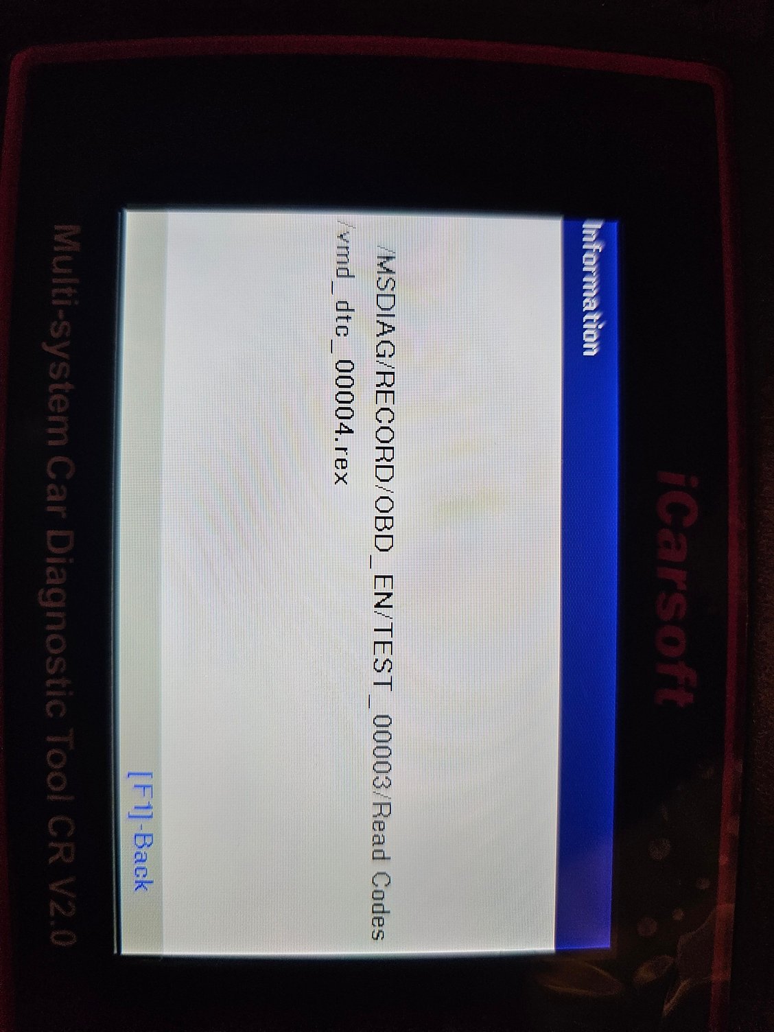

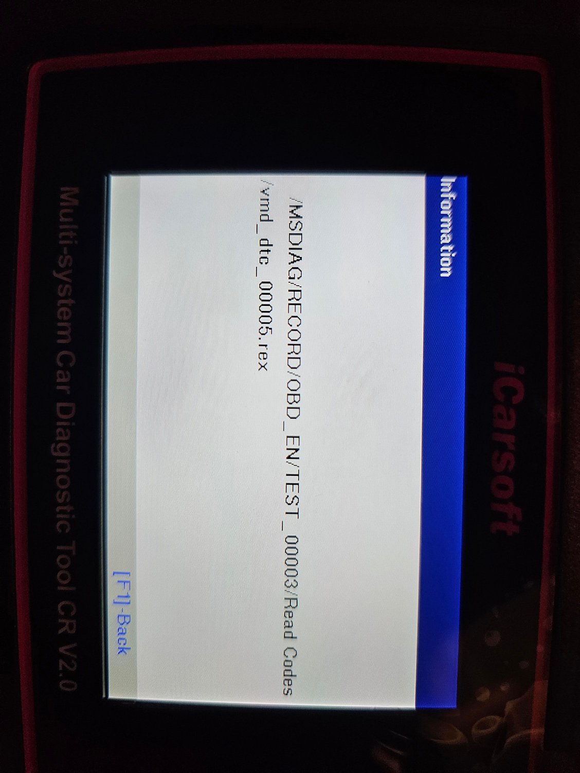

My Jag is showing the error "Failsafe mode" and has a misfire but the only codes it showed were and now they have gone away.
MSDIAG/RECORD/OBD_UK_TEST_0003_ReadCodes
vmd_dtc_00004.rex
MSDIAGRECORD/OBD_UK_TEST_0003_ReadCodes
vmd_dtc_00005.rex

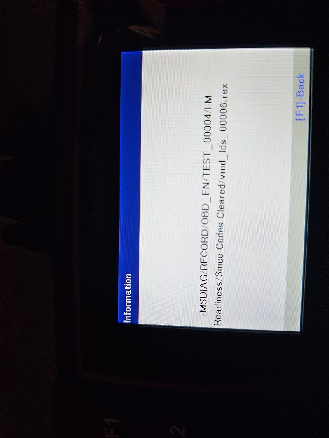

While it was showing the codes I ran a live misfire test with the result being:
MSDIAG/RECORD/OBD_UK_TEST_0004/I-M Readyness/SinceCodesCleared/vmd_IDS_00006.rex
I'm sure the misfire is going to be a coil or two but without codes I don't know which ones to replace and I've previously been advised not to change the all.
Any advice or help would be much appreciated.

You need to post the actual codes you got, rather than whatever those files you seem to have posted the names of.
Those are the codes the Icarsoft reader gave me, photos are below.

Maybe try and update the software on your icarsoft, because that is not right.
You are looking for a code like P0301 etc

Something's wrong with the tool or the way you're using it.
Codes will be like letter(P/B/C/U) and 4 digits. Misfires should be P codes.
