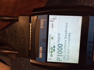

BTW...I just ran a test for codes and the reading was strange. One code "P1000" and then a 'O&D Systems Readiness Test Not Complete' on the screen.
Any thoughts on the code or the Not Complete reading?
Jamie
That relates to the emission system readiness test. When the codes are cleared the ECM has to go through a cycle of testing. When complete it will read P1111.

Once the car has been driven a fair distance, and assuming there are no new sins, the P1000 code will be replaced by P1111 which signifies that all emissions related system self-tests have successfully been completed.

Gus,
I think we occasionally have both codes you mentioned. I found a photo of the code reader from several weeks back with the P0121 code and the wife says the most recent code was the P1121 peddle position sensor. I do know that an upgrade has not been done on the TPS leads to the throttle body. I did notice that the technical bulletin was for 1999-2001 models. Our XK8 is a 2002 model. Will this make a difference? If not, I will repair the TPS leads. I will also clean the TB and PPS connects.
I will also check out the ABS repair link. I will post up the results.
