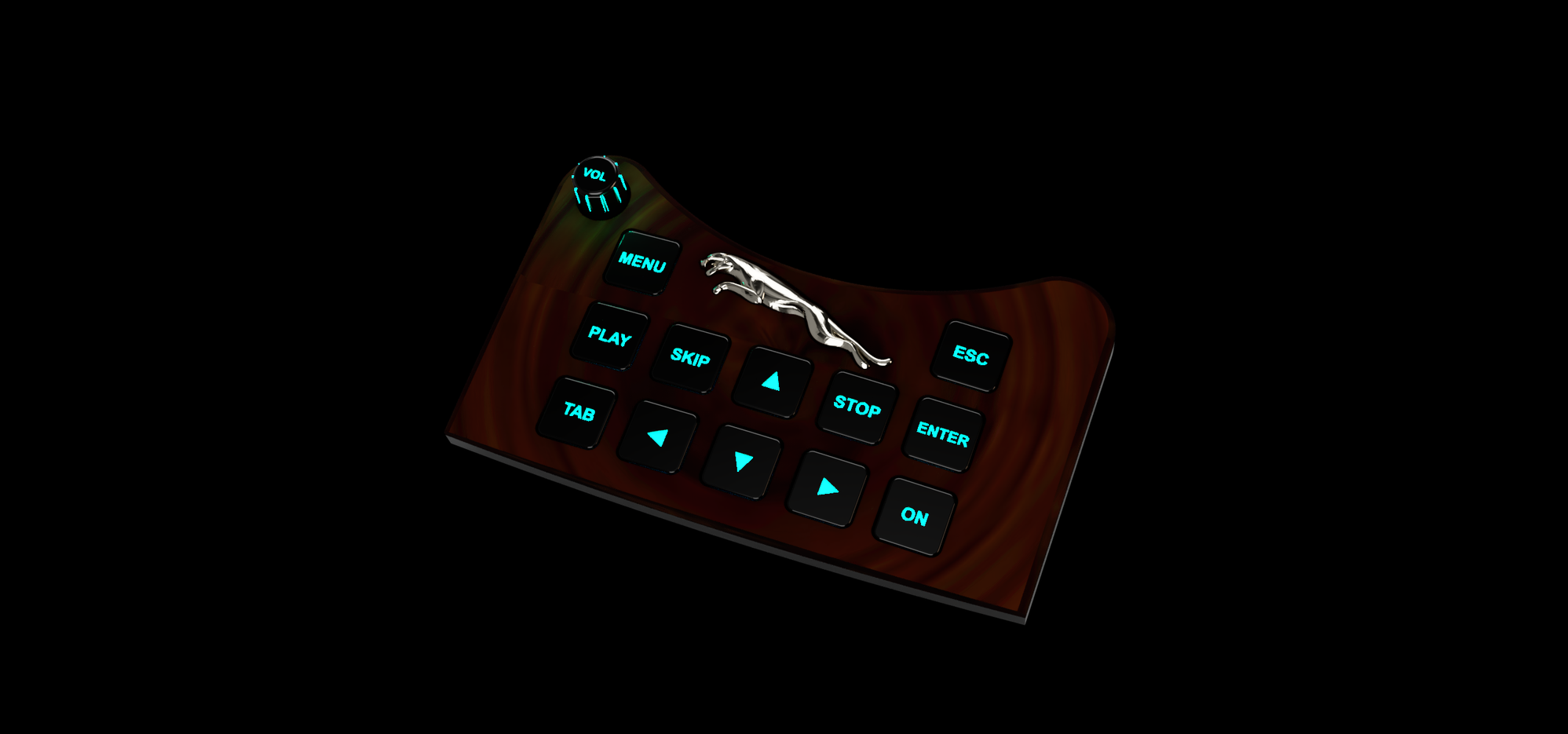

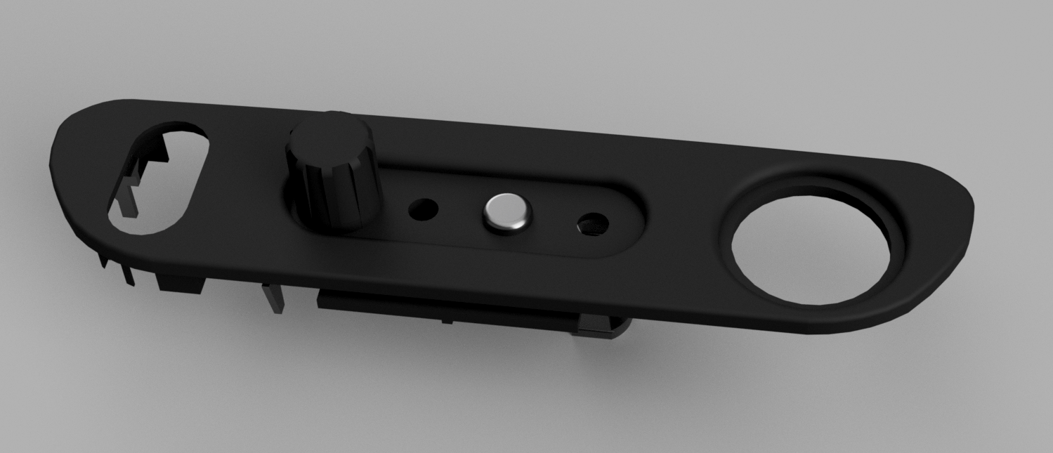

I have finished one of the projects, to make the center console look decent.
Previously I swapped the radio device to a pad and had to move some of the controls on there that could not be controlled by the pad.
Also I wanted a physical volume knob and some buttons to control the media.
I made a plastic keyboard to replace the ashtray, but I never liked it.
So I made a new keyboard and had a woodworker make a keyboard cover in walnut.
Then just 3D printing everything else.
I like it and best of all, it works!
As a bonus you can open the keyboard to access the 12v outlet below.
Render of the center console. Left is the roof button, right is my new hazard switch. Middle is for light leveling, antenna switch, and 3.5" plug for phone audio option.
Render of the ashtray keyboard.
