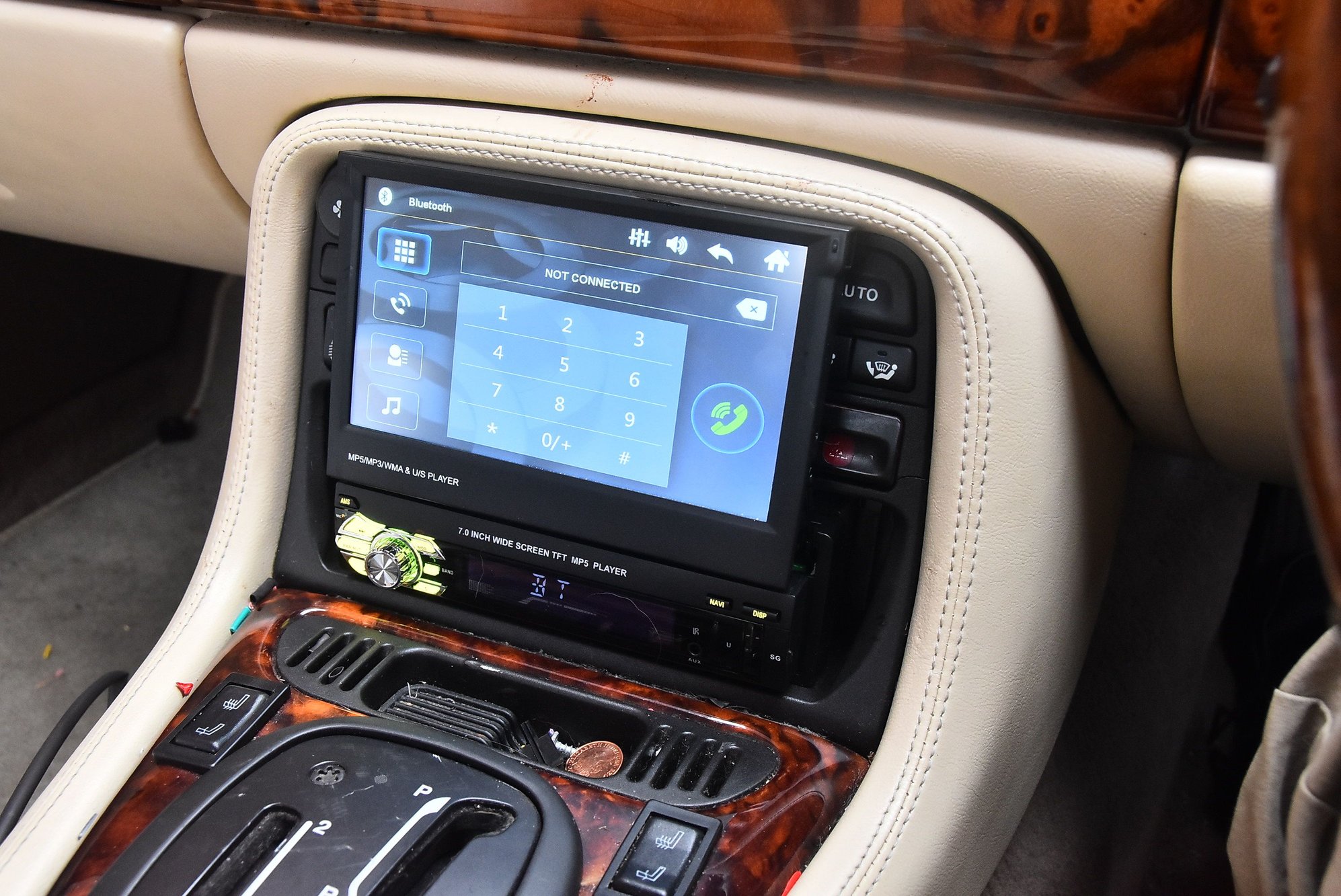

When its finished it looks like this...
The screen folds away. You can move it forwards to access the heater controls no problem.

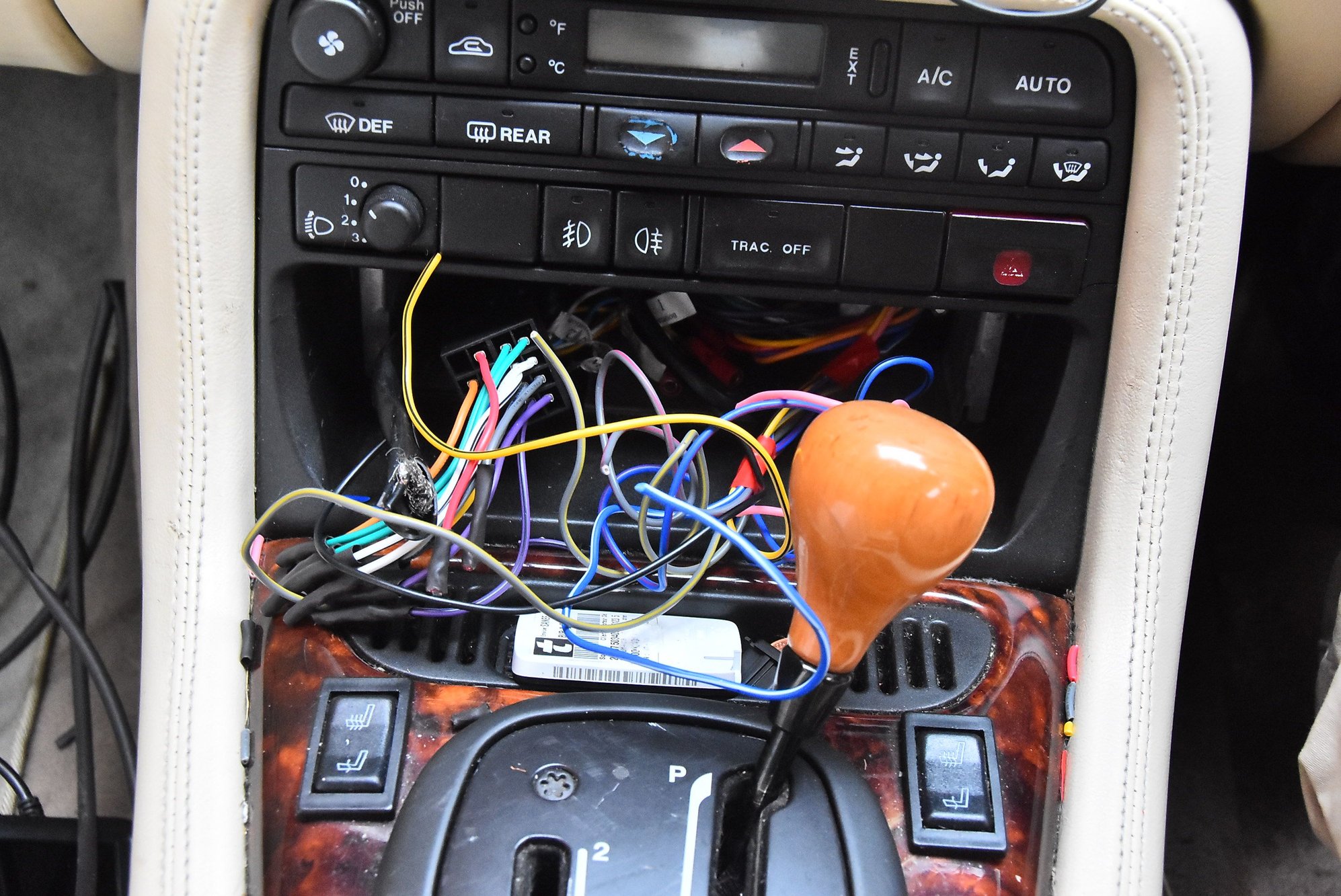

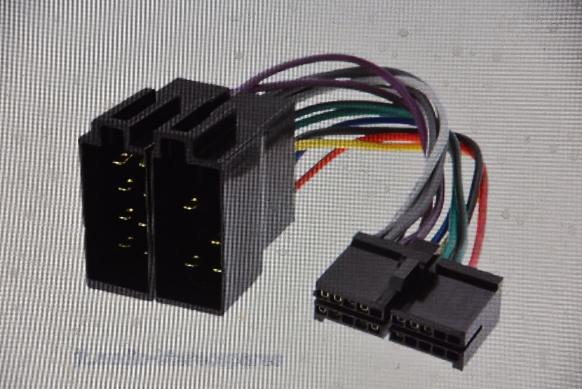

When you pull out the old radio you are faced with a mass of wires none of which match the colours on the jagrepair diagrams. However the speaker wires seem to be standard ISO green/purple/white/grey all grouped together. If you need to check which wire goes to which speaker the best way is to put an AA battery across the wires and the speaker will click with no damage. The continuous live is yellow and the ign switched red. I joined in the illumination wire with the red so when ignition comes on it lights up to match the dash. The mass of wires to the right on the photo all relate to the phone so I cut them off short. If you dont like soldering and heatshrink you can get an adaptor BUT its 20 PIN ISO not 16.
Here is the correct adaptor ,,Ebay

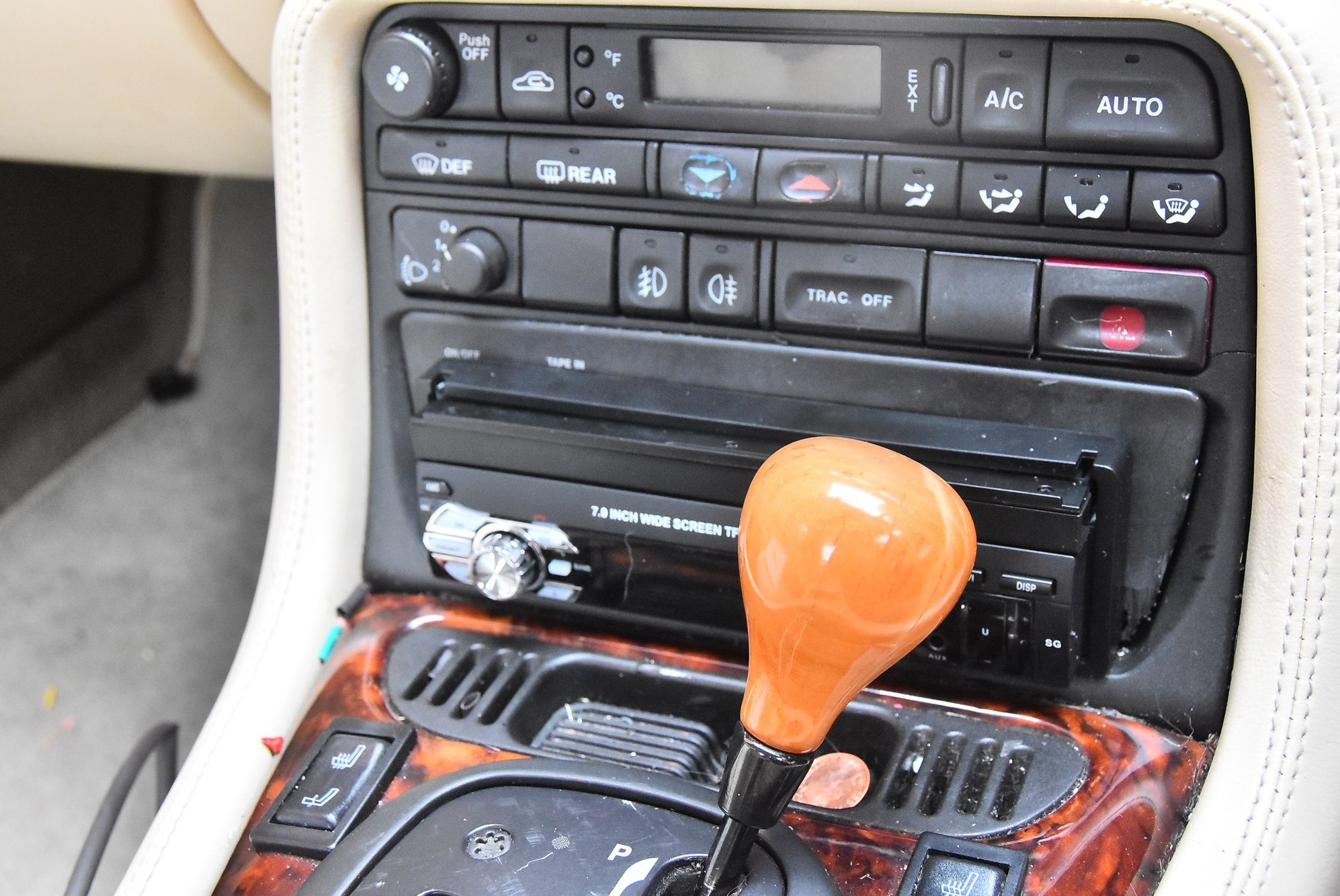

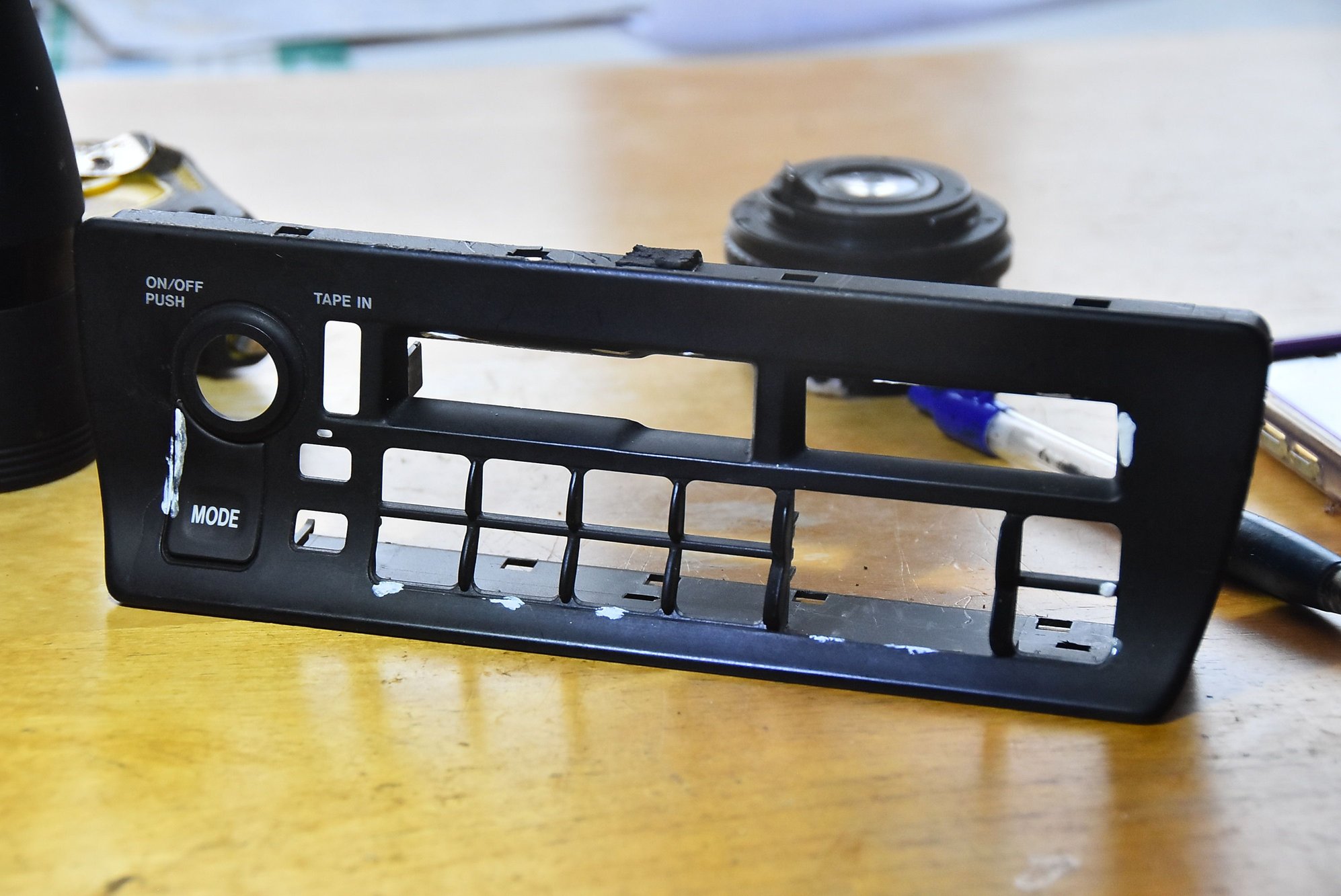

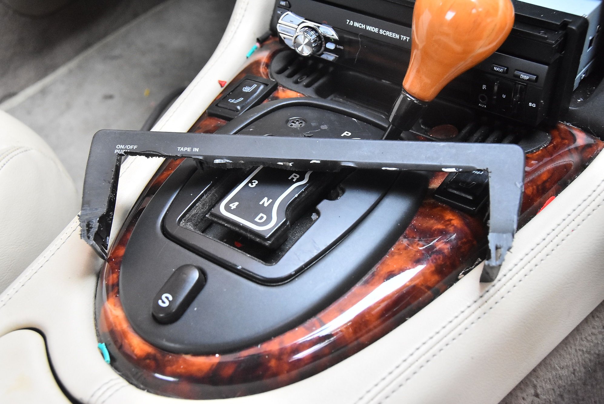

If you fit it straight into the DIN hole you have a gap around the edge. Now I had to force the old radio out so I had a front panel to cut. You could easily cut an inverted U in 1/4 ply and spray it black but here is mine.
and cut
Got to sand off the writing top left. The gear knob in P makes a good anti theft device.
