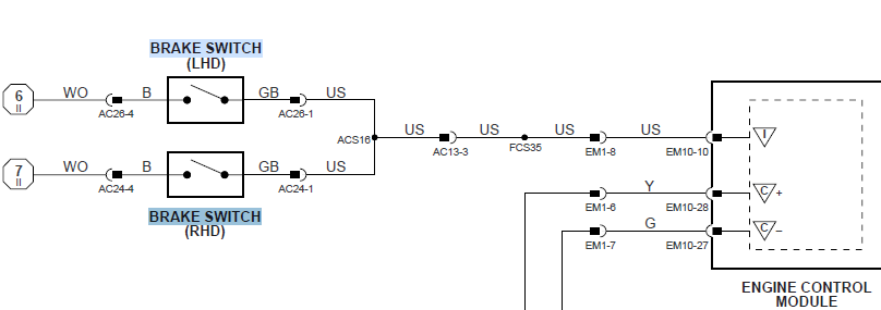

If the shift interlock is also playing up, my guess would be the brake switch, although the high-level stop lamp and LHS rear lamp cluster share the same ground point BT3S on the convertible.
The ECM knows when the brake switch is pressed via the blue slate (US) wire and communicates that to the BPM to fire the interlock solenoid.
However, this wire splices at FCS35 and also routes to the stop lamp relay, so everything prior to the joint (mostly the switch and attendant wiring) is common to both symptoms.
