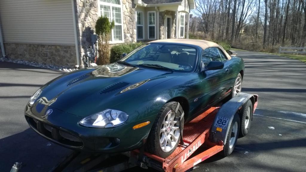

Picked up the 2000 XKR I had been looking at, and trailered it home yesterday. She has engine problems that I will be digging into, and fix if possible, or replace the engine.
It was quite an adventure, and with engine parts filling the trunk, it will take some time sorting things out.
I am finally a Jaguar owner! (I am embarrassed to say how cheaply it finally went for.) Pic will be added shortly.
Let the fun begin!

Default Kitty Pic Added
Updated the original post with the XKR as picked up. It may be a while before she sees anything other than the garage, but we shall see. This being my first post-retirement project, I do have some time available. No idea until the heads come off how bad things are, or if the whole thing needs to come out.
Fingers crossed!
