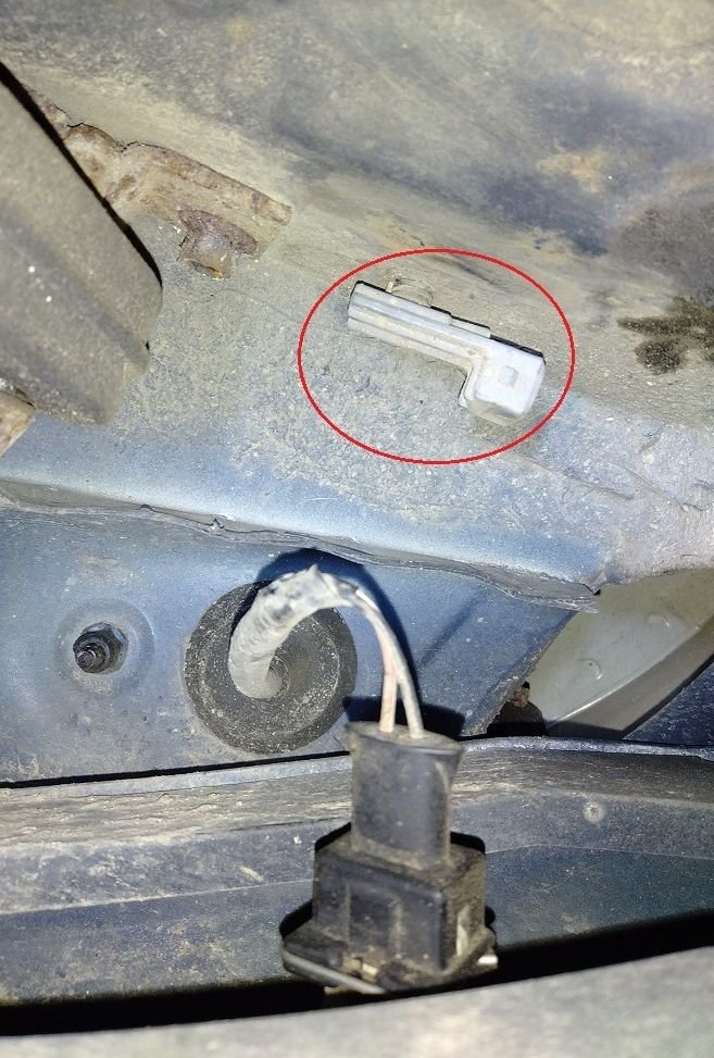

I have a 2004 XK8 in the U.K. when I replaced my side marker lights, there was wiring for the fronts that came on with side lights but I couldn’t find any wiring for the rears, does anyone know if this is the case on later cars ?

@Javlin1961 - The wiring for the rears on mine drops out of the boot floor adjacent to the marker, although it was originally 'parked' on the circled clip so may appear to already be going somewhere?:
