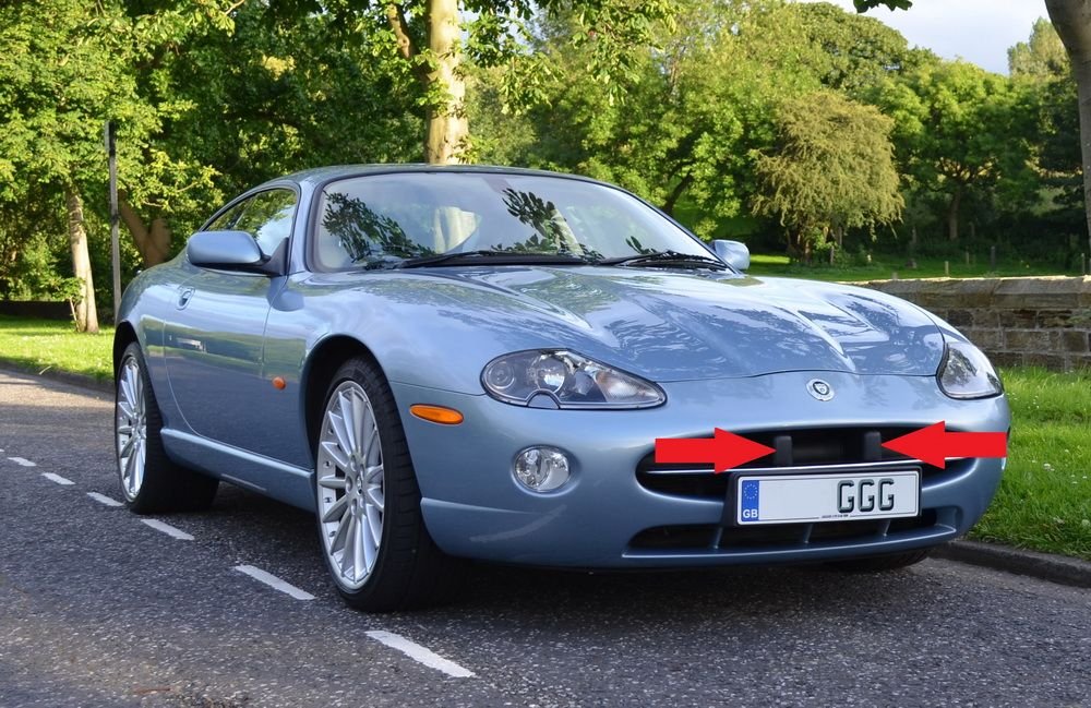

Still there on the 2005 but not as obvious as on the earlier 4.0. My 2001 XK8 4.0 on the right and 2005 Final Series XK8 4.2-S on the left:
Mostly hidden by the standard UK size registration plate bracket on the later car.

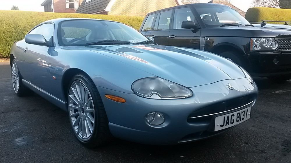

YES - I traded it in 2013 for a 2007 XK which has since also been replaced. A newbie found it for sale again on the south coast of England in late 2016 and sent me this photo. It was still looking good:
The 4.2-S Final Series is the RoW equivalent of the US Victory Edition. All the options included in the specification.

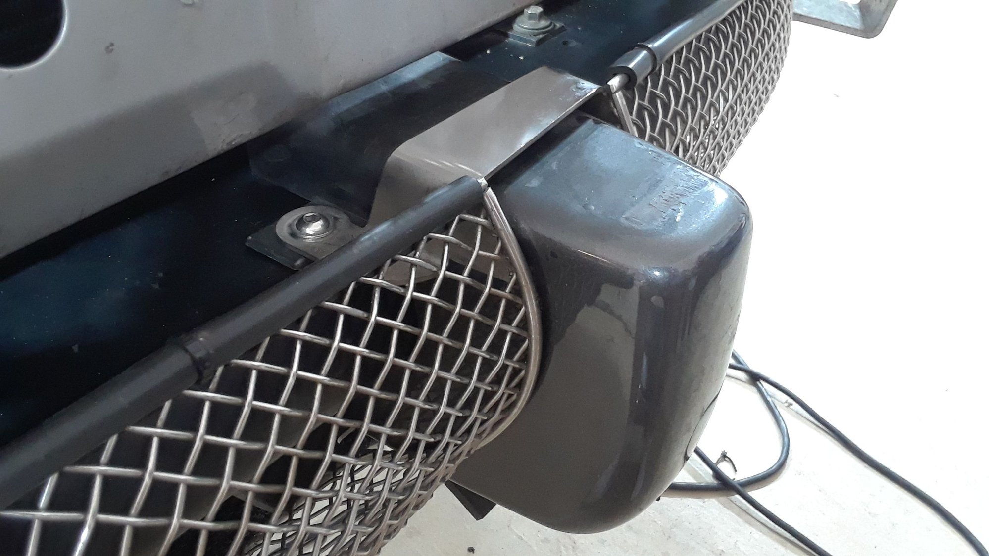

Same bus, different seat. I recently started to tidy up the front of my new toy and found the plastic covers for the bumper over-riders were intact but quite badly scuffed in several places, so I decided to remove and repaint them. The main bumper cover came off quite quickly and easily but the grille and over-rider covers....not so much. After skinning both knuckles fighting and destroying the age hardened fir tree clips that hold the grille and over rider covers to the bumper, I decided there was a better way, and replaced them all with M6 stainless socket screws into Rivnuts. With the plastic covers finally in hand, sanded and prepped, the question for the Forum is; what is the name or code for the metallic dark gray/anthracite paint that seems to be universal to all covers on XK8/R's of the era, irrespective of body colour. I've searched all over without success so, before winging it by eye at the Duplicolor rattle can rack I thought I'd ask you folk?
