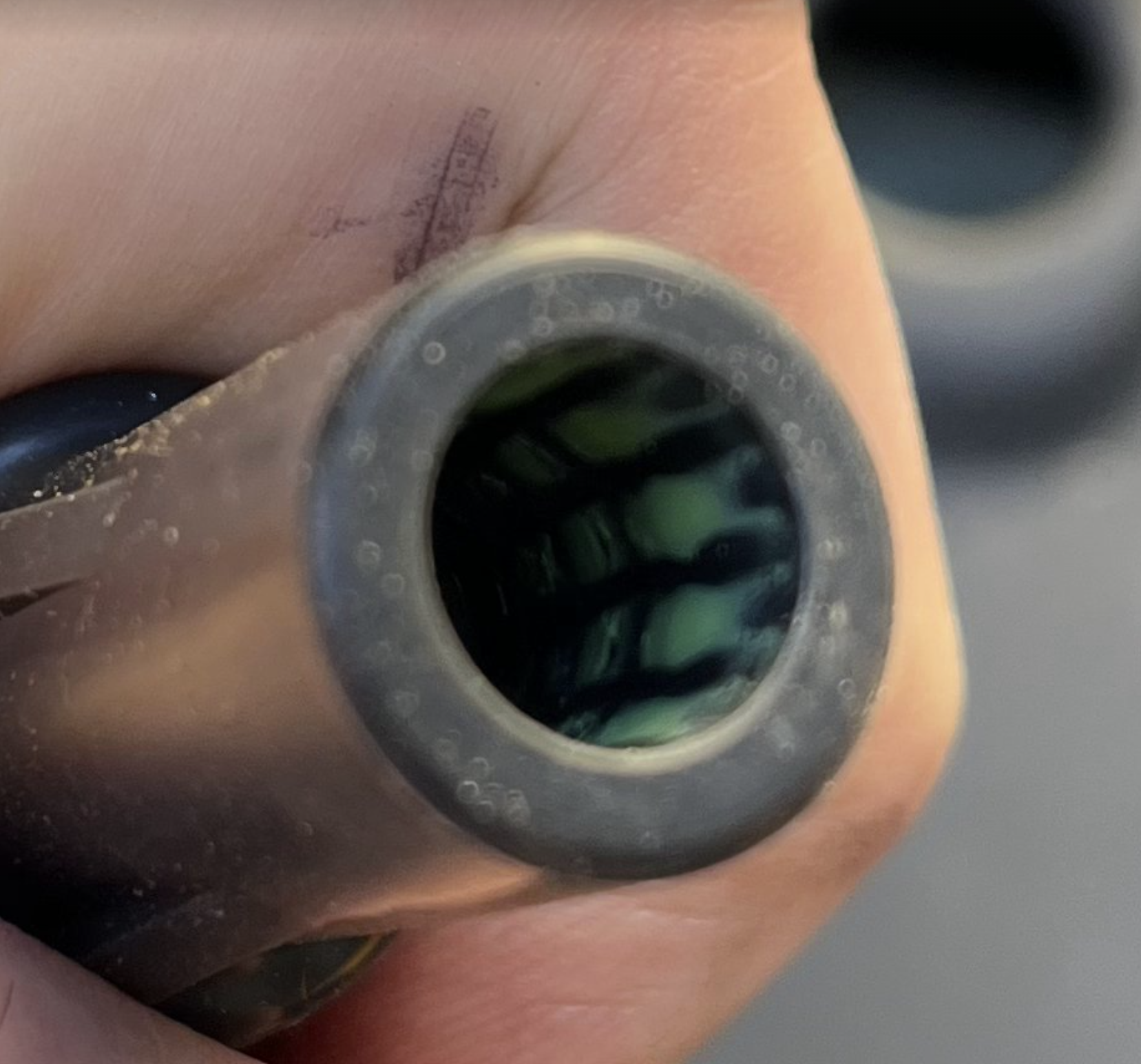

We have a smoking gun. I pulled the #s 1 & 2 coil and plug today and found the #1 coil boot to have corrosion inside the boot. The #2 did not have any corrosion. The plug wells were dry. I cleaned out the corosion and it's running fine now.
There must be water getting into the #1 plug well (maybe #2 also). It could be that this was just me kicking myself when I rinsed off the motor with a garden hose after changing the water pump (how else to get rid of all that coolant - and yes, I drained it from the radiator drain). Or it could be a sign that water is getting into the plug well when it's raining. The upper coil seals seemed fine to me.
If anyone can report a similar issue, maybe it's a rain issue. If not, it's likely just another occation of me kicking myself in the nuts.

I read the codes indicating a coil failure. In all prior occations, I either moved the failed coil or swapped it for a new one, confirming the failure.
That copper corrosion is more than enough of a path to short out the high tension side of a coil.
I cannot correlate rain with prior failures. Although that's the basis of my question here. Has anyone else expereinced front coil failures? Or am I the only one that drives these things in the rain? lol
