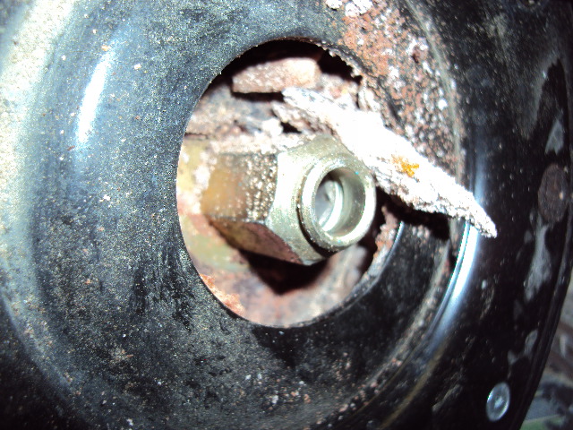

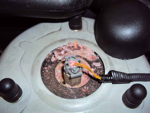

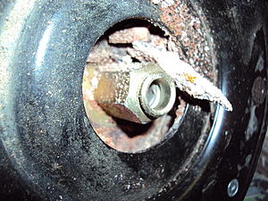

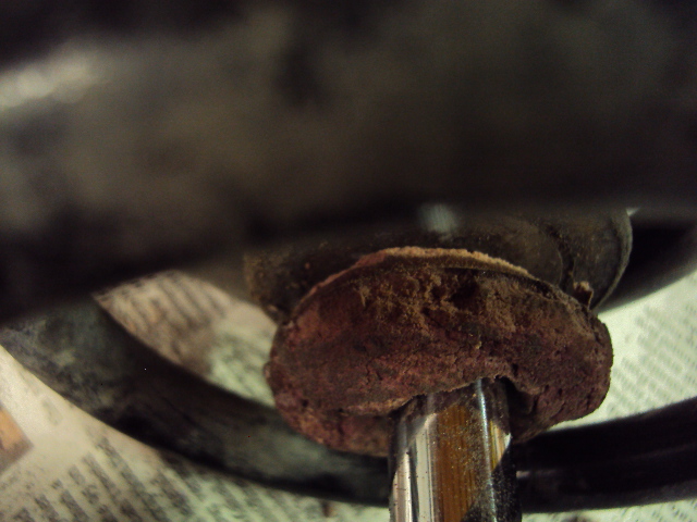

It's been 2 years since I've logged in. My 2000 XKR hasn't given me much trouble; but I haven't used it much. Well I've experienced some strong thumping in the front suspension over rough roads. On the lift everything looks good, even the sway bar bushes. Then I pulled the cover off the top of the shocks in the engine bay; where the CATS wire connects, and I found what looks like crumbled plastic. Is this isolator material in the upper spring mount?

Steve, the color is confounding me. Looks the same as the electrical connector housing. I'm sure you can see the difference standing in front of it.
If it is different material/issue then yes I sure would suspect the upper shock mount as the source of the noise and the crumbles.
How do you test? Measure ride height. Center of front wheel to top of wheel arch. I don't have it memorized, someone will surely jump in and spec it out for you.
Or you can do a quick search on ride height. We've had many discussions in it. Get the Polly replacement- far superior in performance and longevity than the one you posted a photo of. I believe our sponsor SNG barrett sells them.
John

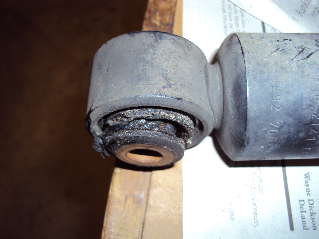

Default Yup mount plates are shot.

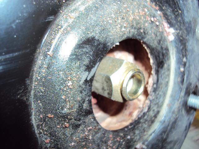

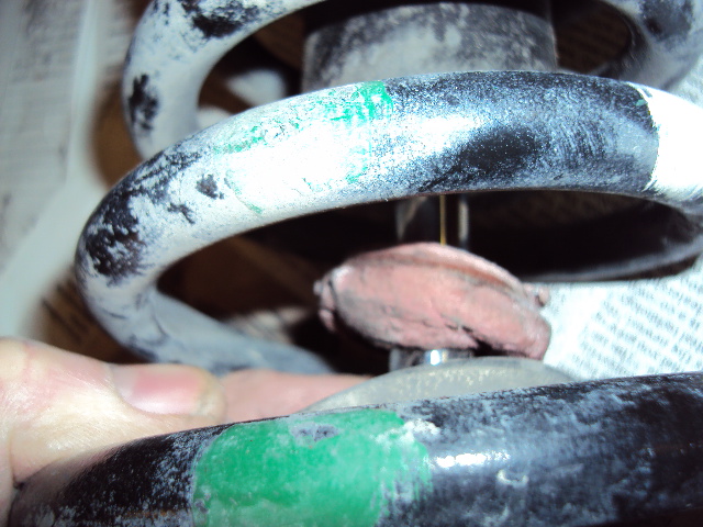

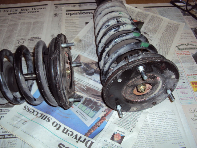

Got the spring/shocks off my 2000 XKR today. Mount plates and bump stops are totally perished. All of the cushion material is gone. The rubber boots on the lower bushes are gone too. New mounts, bump stops (spring assisters) and lower bushes were only $205 + shipping from SNG. Thankfully, no leaks emanating from the CATS shocks themselves.
