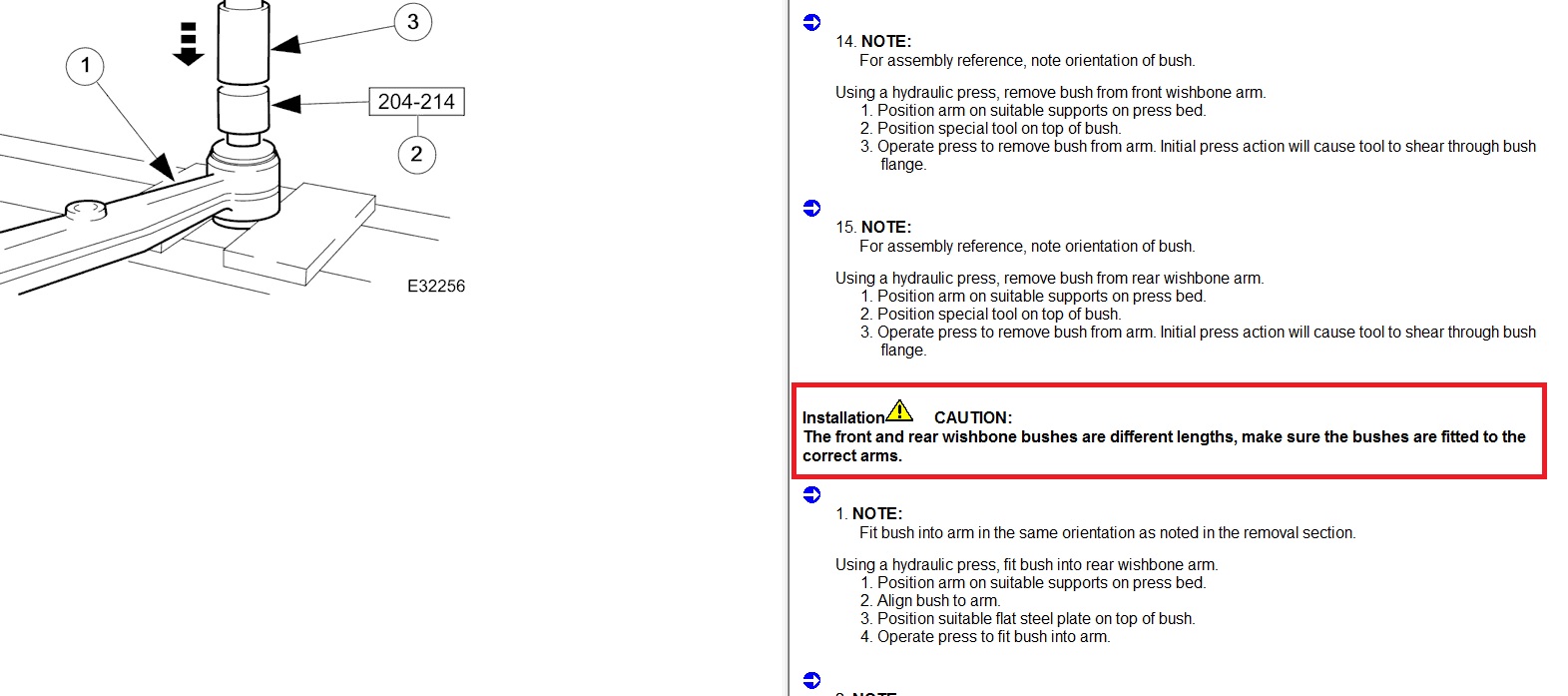

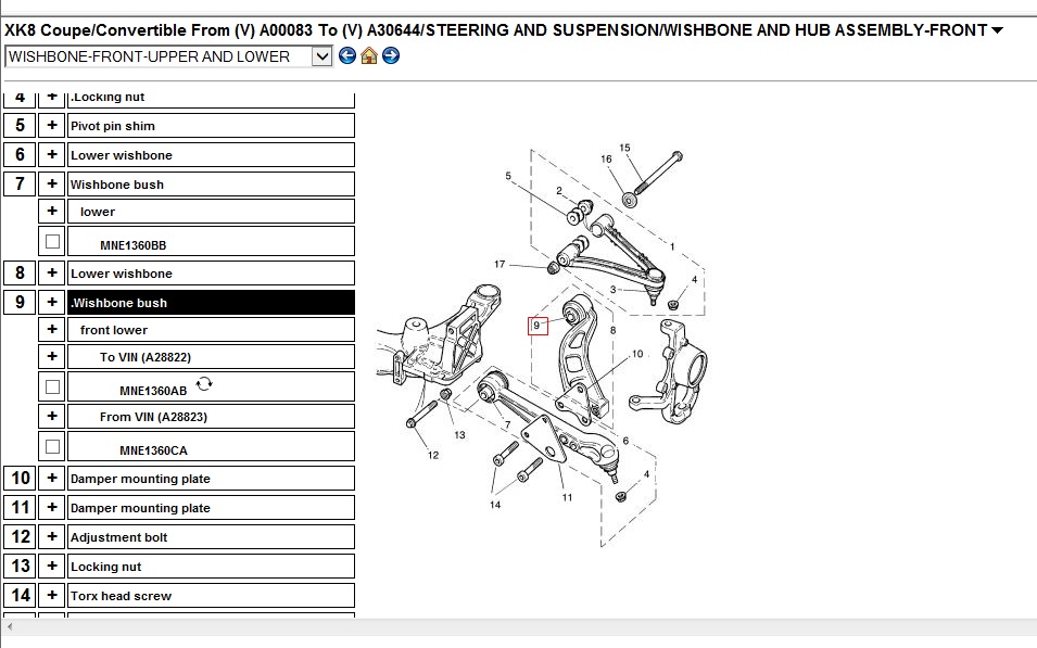

Can anyone clarify please? Jaguar have two part numbers and two prices for lets say the forward and rearward wishbone bushes on the front suspension, one is nearly twice the price of another.
Alternative suppliers (British spares) sell just one bush for both arms, other suppliers likewise.
Who's right? Have the bushes been revised to just one design now?
Old Sep 25, 2013 | 10:53 AM
Likes: 17,008
The OE bushes are different lengths. Here is the warning in JTIS:
There was an upgrade on the front lower bush fitted from VIN A28823 and the earlier pattern was discontinued.

Jaguar Cars is aware that dealers have been using the rear wishbone bushing MNE
1360BB in place of MNE 1360AB in the Front Lower Wishbone on V8 XJ vehicles for some
time. If, after inspection of the vehicle, it is determined that MNE 1360BB is already in
place, replacement is not required.
In TSB http://www.jagrepair.com/images/TSB/...ng%20specs.pdf
I installed the British Parts lower bushes 6 months ago, ok so far, however, do not buy their upper bushes, they are terrible and do not fit.
The Rev Sam had problems fitting his Brit Parts lower bushes, mine were also tricky to fit but since they were the first ones I have ever done I have nothing to compare it to.
