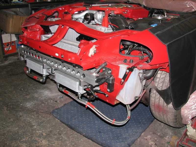

I made my own, a lot cheaper, I had to replace the cooler and £30 was much better than £200 which was the main reason for the hoses as the OE items would no longer fit with those terrible block connections

Cool. Braided steel lines look so much better.
Are the two cooling rads separate for engine and transmission oil.
Radiator now handles only coolant?
Looking at your Mods is making my wallet shiver.
More pictures please.

Yes that is correct........ Everyone is so concerned with keeping the intake temperature down, with both pulleys done I was also concerned to help keep the engine temp down too.
I used a 3" aluminium radiator from an Evo as the main pipes were roughly in the same place and size was close, still needed playing with but only cost £150 ($225) instead of £600 ($900) to get one made, I then ditched the fan pack and put a pair of the largest fans in I could, seperated the supercharger from the main water supply as well...... Stroked it to a 4.2 as well

Can you elaborate on separating the supercharger cooling from engine cooling?
What is that big knob on the thermostat pipe?

I run a standard thermostat 84*........
Separating the system is easy enough, you will need a much stronger pump, the Mercedes one does the job, also another tank to hold extra water, I also made my own header tank which also acts as a cover for the original header.....
I will have to take some pictures when it is all back together again....
I am unsure as to the "knob" you are referring to
