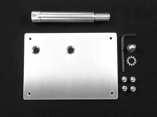

Posting seems a little strange today for some reason. Somehow managed to delete my original post, but just ordered the Axle Company LLC front license plate mounting bracket, pictures when it arrives.
Marcgr, thought about doing something like that, but I"m trying to limit how much I restrict airflow through the grill. I see you're in Texas too, so you know how hot it's been lately.
Here's some of the info on the bracket.
The unit mounts to the towing eye fitting attachment point under the front bumper. The only concern is that the manual says not to drive with the towing eye fitted, but it appears it slopes down and I'm hoping the license bracket has been designed to compensate for this.
Mower Deck Axles,Carrera,Cayman,John Deere,Kubota
There were no pictures of this unit installed on an XK8/XKR, but here's a link to a different car forum with pictures of a Porsche 997.2 Carrera with one installed.

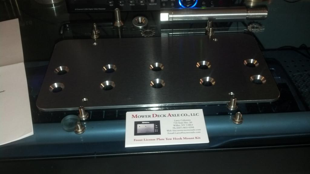

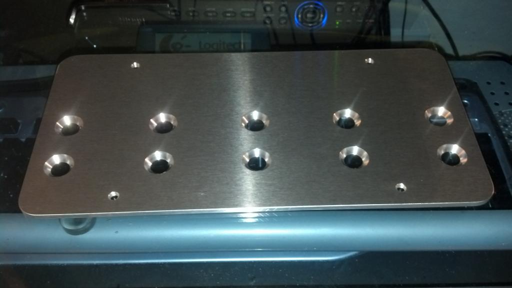

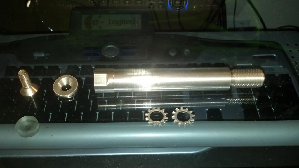

I received the license plate bracket kit from Mower Deck Axle Co. yesterday and got setup to do the installation this morning while it was still cool out. First the good news. I was initially impressed with the care taken to just pack the kit and upon unpacking very impressed with the quality of the workmanship. The instructions were clear and concise. The kit included a 10 degree angle fitting to compensate for the downward angle of the towing eye fitting and two sets of license plate mounting screws, one for just the plate, and a second slightly longer set for the plate and a frame.
The installation instructions suggest fitting the towing eye before installing the license plate mounting stud to insure the threads are clean, but since I don't have one this step was skipped.

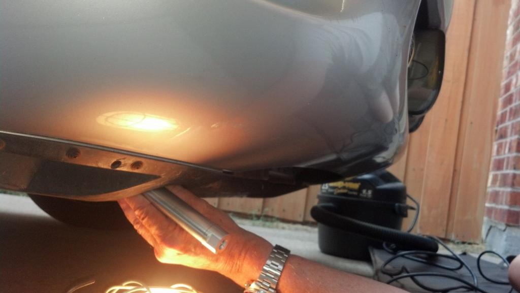

I did observe some lint like material in the fitting which was removed using a shop vac. Observation indicated the fitting was probably smaller than the threaded area on the bracket mounting stud. This was confirmed when I tried to install the fitting. The stud is also reverse threaded, but I was unable to verify wheather or not this was the case on the XKR's fitting due to the oversize stud.
The other issue, and the real deal killer, is the length of the stud. The stud is about 7 inches long, and as you can see from the following picture, substantially shorter than required. Larry at MDAC did ask me to verify the length of the stud was correct, so apparently I'm the first XK8/R owner to give the kit a try. The stud would need to be between 13 and 14 inches long to clear the front of the Jag. The problem then becomes ground clearance would be about 3 inches, which would be a real problem if not with suspension travel, which it would, but with any road irregularity or speed bump you might encounter, not to mention curbs.
I'm really disapointed that this unit didn't work, it is very well made and would have looked great on the XK. It would also mount the license plate out of the way of the radiator, which would have not impacted cooling as much as a center grill mount. One concern I did have is that the plate would be mounted more toward the center-line of the car. When conbined with the reverse threaded stud, this would produce a leverage effect that would tend to unscrew the stud. This is conjecture, of course, as I did not get to test it.
On the X150's which have the fitting behind the bumper, like the Porsche pictured in a previous post, this fitting would probably work just fine, but based on my experience, not on the X100. To bad, guess I'll have to go a more conventional route.

To confirm the question about the Towing Eye. It is M20x2.5mm LH thread on the XK8/XKR (the smaller M16x3.0mm LH thread Eye fits the later XK and X400, X200 cars).

The fitting was LH thread, but I could not get it to start threading because it appeared oversize. I'll try and mic it later and see what diameter it is.
