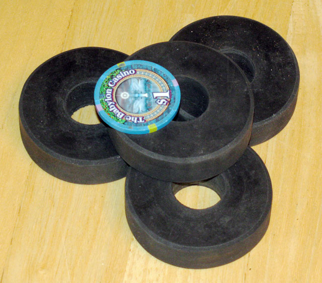

I made my own, 4 bushings, out of neoprene, durometer shore A 40, ~2.5" od x ~1"id x 3/4"thk. They seem to work pretty well. I have enough for 3 sets of 4 bushings each.
I'll sell them for $45.00 per set for the XK8's...if anybody is interested.

I just spoke to Bill on the phone and ordered some of these neoprene disks from him. I've been wanting to replace my upper shock mounts but I've always balked at the price Jaguar wants for a little bit of rubber. After talking to Bill I'm pretty sure this will be a relatively easy DIY job. I'm pretty handy, and it's going to save me about $250-$300. I'll make a video, of course.

WOW! I received the rubber bits for the upper shock mounts from Bill (wlbusmcr) today. I'm beyond impressed. I was expecting some rather raggedly cut donuts of rubber. These things look like they came out of a factory. The edges are beveled, they are all identically sized. I haven't tried to install them, yet, but they appear to be perfect. Here's a pic:
Bill says I also need some liquid urethane and a 1 foot square sheet of 1/4 inch rubber, which I can get from mcmaster.com. I'm going to order the stuff I need, which should cost about $50, then replace the shock mounts next week.
