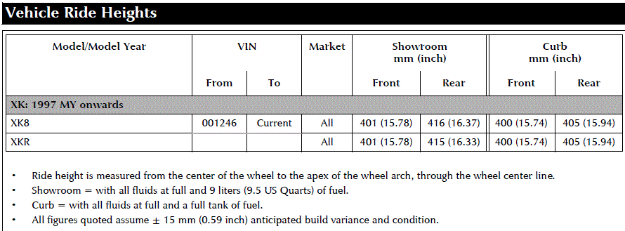

Thanks, what is the easiest way to measure the ride height? From ground to where?
Old Apr 10, 2021 | 07:00 PM
Johnken's Avatar
Posts: 5,457
Likes: 1,816
From: New Jersey USA
Measured from center of wheel to bottom of wheel arch above it. IOW the bottom of the sheet metal lip.
John
Old Apr 10, 2021 | 07:39 PM
alanroberts50's Avatar
Posts: 428
Likes: 91
John
Thanks John that seems fairly straightforward but I forgot to ask what that distance should be?
Old Apr 10, 2021 | 08:01 PM
Posts: 428
Likes: 91
Found another thread that said the magic number was 15". My rears are 15.25" and my fronts are both 14.5" Would that be enough to cause inner tire wear down to the canvas. (it doesn't even look gradual across the tire its a very sharp wear almost on just the one inside tread on both sides)

That's more than an inch low at front which will result in camber way off spec and inner shoulder wear.
your top mounts are relatively easy to visually check for condition. Start by looking at top shock mount in engine bay. You very likely will find crumbling foam residue.
