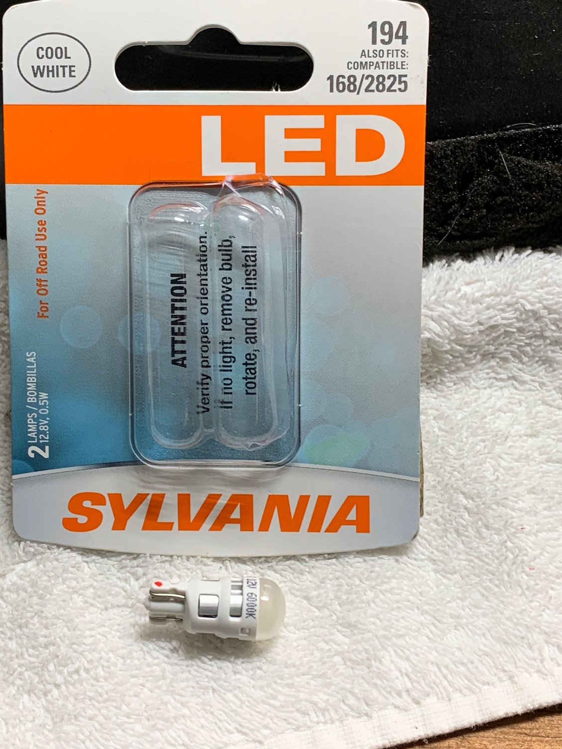

Originally Posted by Daveyj42
“……….. And I'll stick with old world incandescent bulbs in the future!….”
Just an FYI, the Sylvania LED’s are polarity marked. Using those has helped me have trouble free installations.
below is just an example of the ones I used in the dash cluster. Red dot is the positive side:
