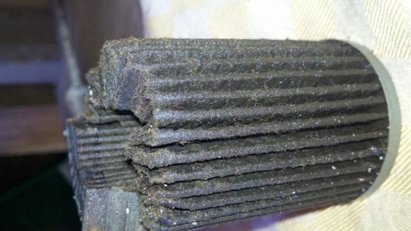

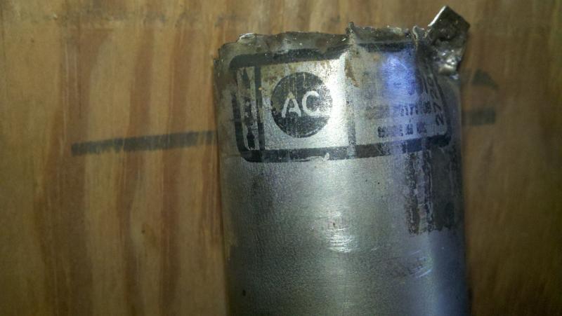

Fuel pressure is 32 psi before filter change, and 32 psi after fuel filter change.
I hacked up the old filter to see what kind of shape the element was in.
Dirty shape, that's what kind of shape!
While I was getting dirty, I changed the oil.
Put in Valvoline 5w-30 full synthetic.
Gotta remember to keep an eye on the wife's oil level.
Only got about 4.5 quarts out of the car. I guess she burned about 2 quarts since the last oil change (Thats leaving a guesstimate of 1/2 a quart still in the galleries and such).
Last change was about 4,000 miles ago.
Now do I bite the bullet and change the fuel pump, or wait.........
It is her daily driver, and I guess I should bite the bullet and change the pump on my own terms, and not in a service station waiting room.
