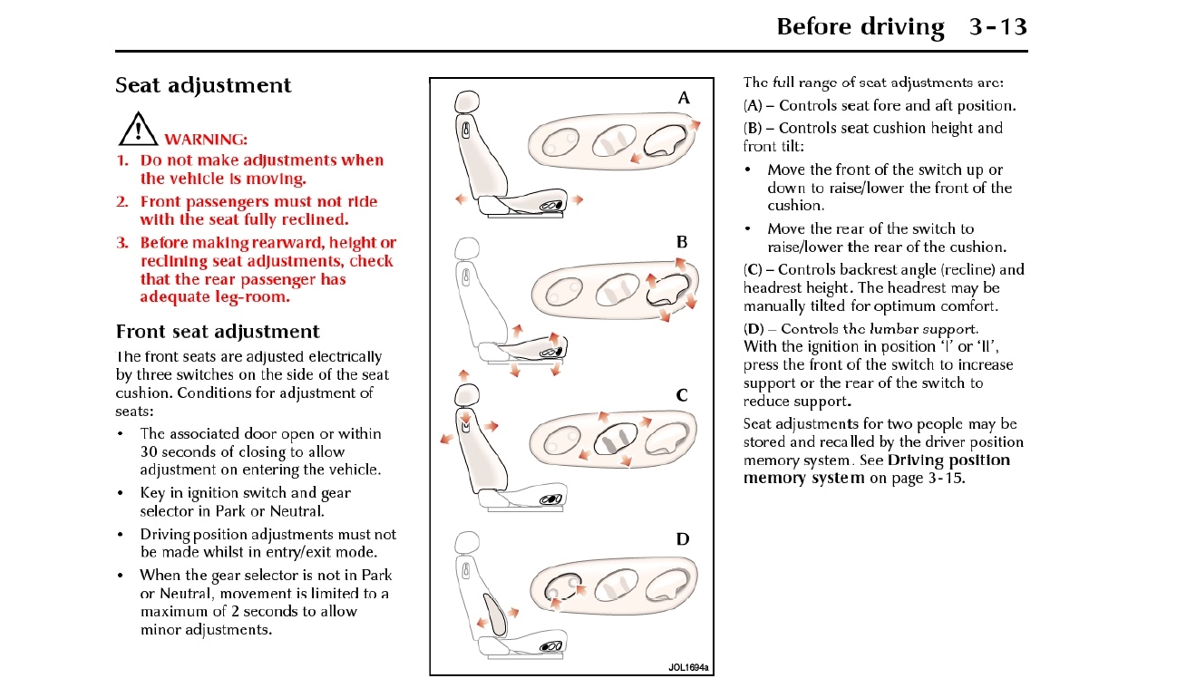

Which lever are you raising?
The front button on the switchpack is moved in the direction shown in 'A' to move the seat backwards and forwards.
