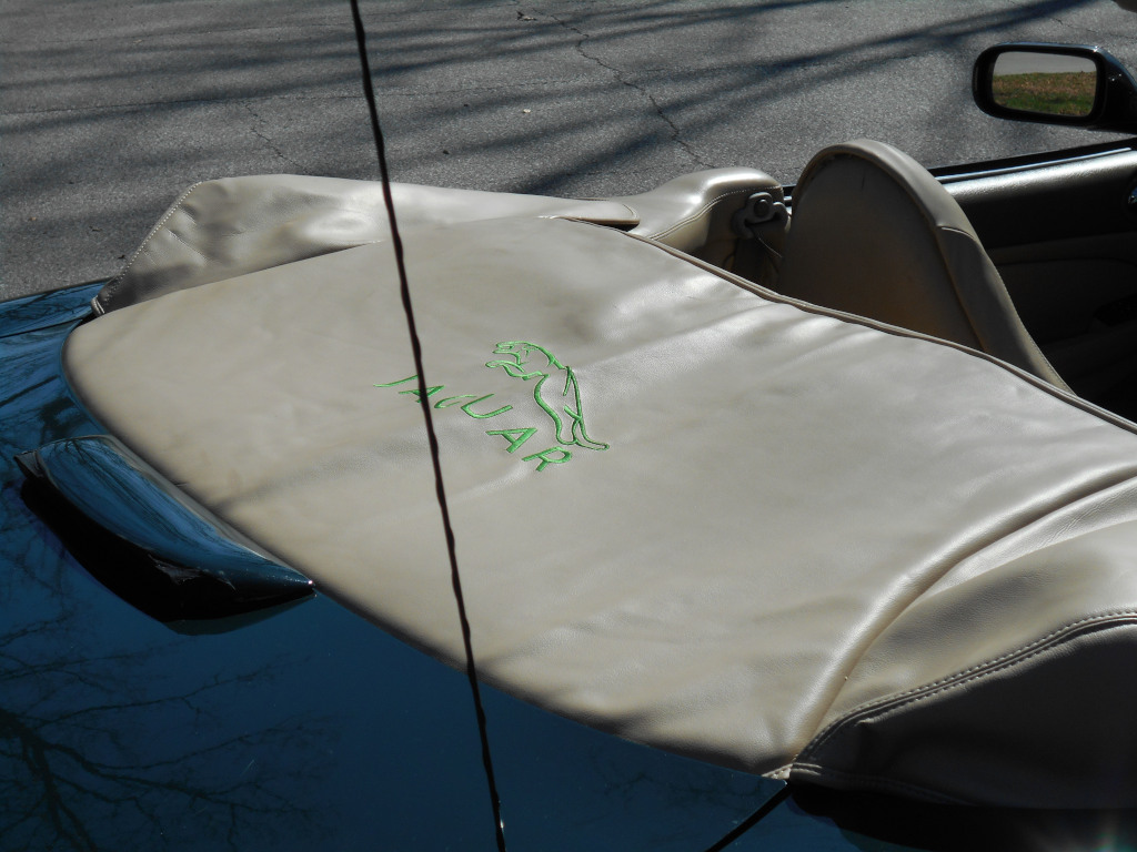

So far so good. My project is coming along. I upholstered the seats, got the matching cover for the roof, and added snaps to the front of the cover, so I could snap it to the back of the back seat, and the wind won't get under it. The wrinkles will come out of the seats, once the temp warms up, and a few fat people sit in them. Please don't comment on the console cover. I will get another one later on, when I can afford one....

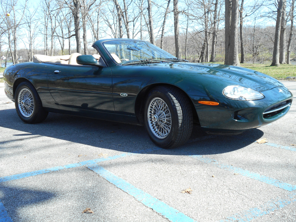

I skinned the outer inch on the top of the front brake calipers, and added 1.25" spacers to all 4 wheels, so they give the car a more aggressive look, and removed the bumper guards.

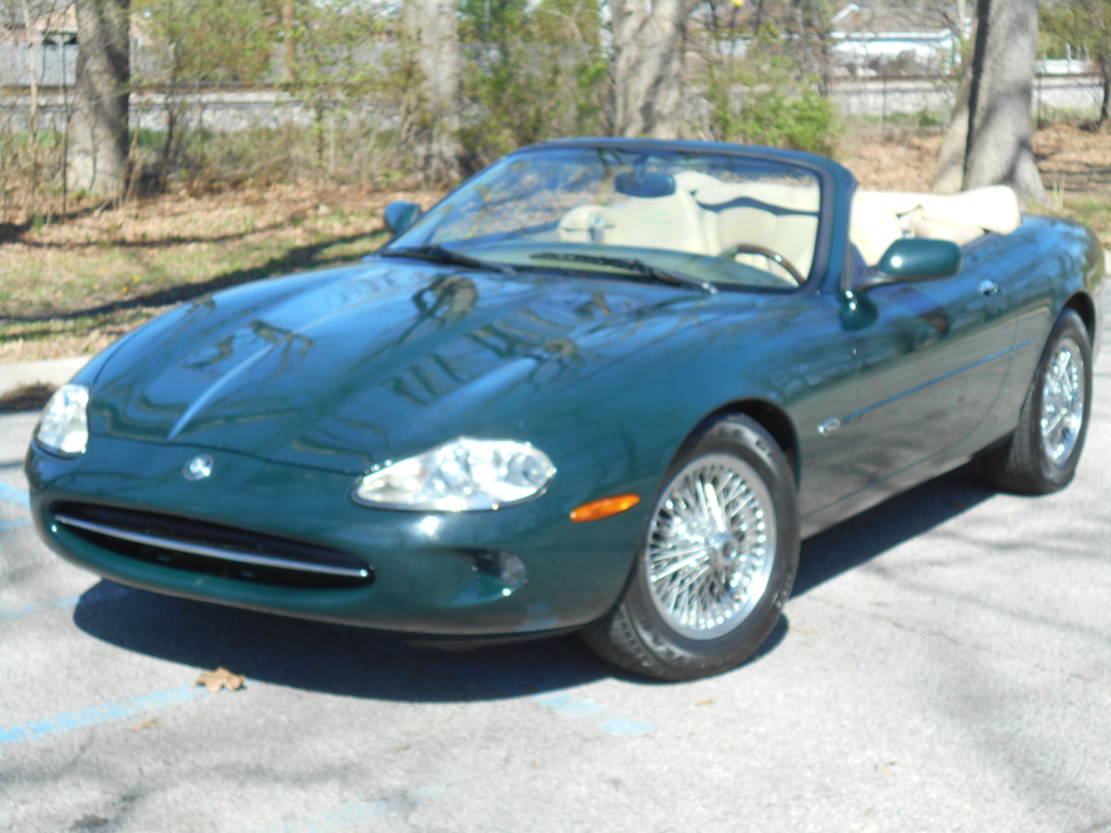

I got the Dayton wire wheels for $550 on ebay, and a trip to the middle of nowhere. They came with new Goodyear Eagles mounted on them. I chose the 16" wheels over 17", because with a taller tire, the circumference is the same, and it looks more vintage, even though the width of the tire is the same. I measured the front calipers, but was a little off, so I had to take about a quarter of an inch off the top of them, so there would not be any wheel interference. They drive well, but you get a bit of a vibration around 75mph. I am hoping this will go away, with a little more driving, but my XKE had a similar issue.

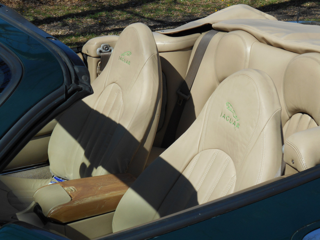

I resealed the convertible top with a product that was recommended on the forum called RaggTopps. So far so good. The embroidered front leather seats were a bear to do. I got them and the boot cover for $450 off of ebay, and was the only bid. I guess it helps that my interior color seems so different. I have recovered seats in Dodge Challengers, MGs, a Pontiac Lemans, and a few in kids cars who came to visit me, so I can pass on my knowledge to them. The bottoms were a snap, but the backs required around 20 wooden wedges, clips, and some leather glue, as well as an overnight stay in front of the garage furnace blowing on them.

Mike - looks great, especially the wire wheels - definitely eye catching. Did the seat backs come with the Leaper embroidered or did you send them off?
If sent out - where and how much as I have been considering something similar when I get the new seat covers.

I have been admiring your XK from previous threads,especially the wire wheels. I understands it came to a sad end. Did you have any problem with the wheels? I am considering adding wires to an XK later, but most who have had them on earlier cars do not seem to think they are a good idea.
