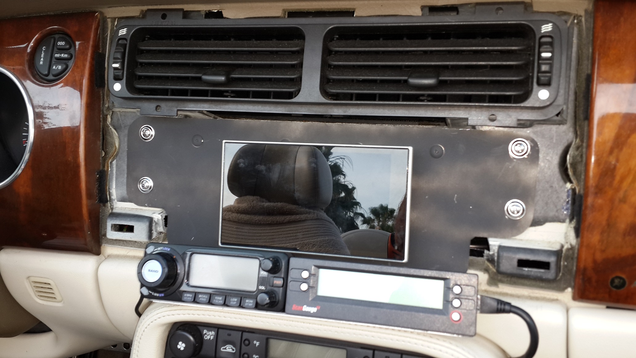

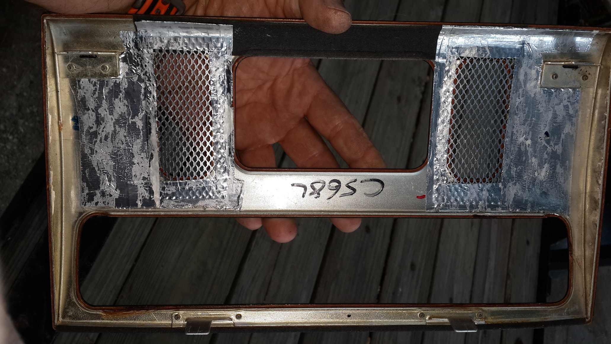

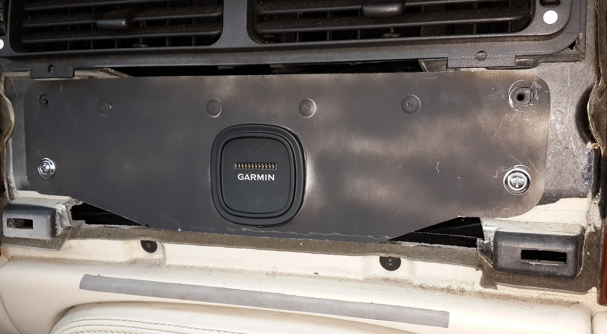

Got tired of looking at my 2003 XKR stock GPS display! Remover the original GPS display unit and fabricated a mounting plate to support a modern Garmin touch screen gps. Using drywall patch metal grid, I covered the two holes used for the original gps control switches. Using a standard 12VDC socket with leads extending to the passenger side fuse panel, the new gps was connected to a switched circuit. The installation looks nice and functions well. Also, the new gps can be easily removed (using it's original magnetic mount) to install software and data base updates. Please see the attached photos of the installation process.

I used the standard Garmin power cable that came with the GPS. Plugged it into a standard accessory 12VDC socket and then terminated to one of the power feeds located on the passenger side fuse panel. Didn't have to do anything with the GPS power supply wiring. The circuit used from the car was switched with the ignition switch. Everything works seamlessly!! Wish I would have seen the YouTube video before starting the project, will check it out.
