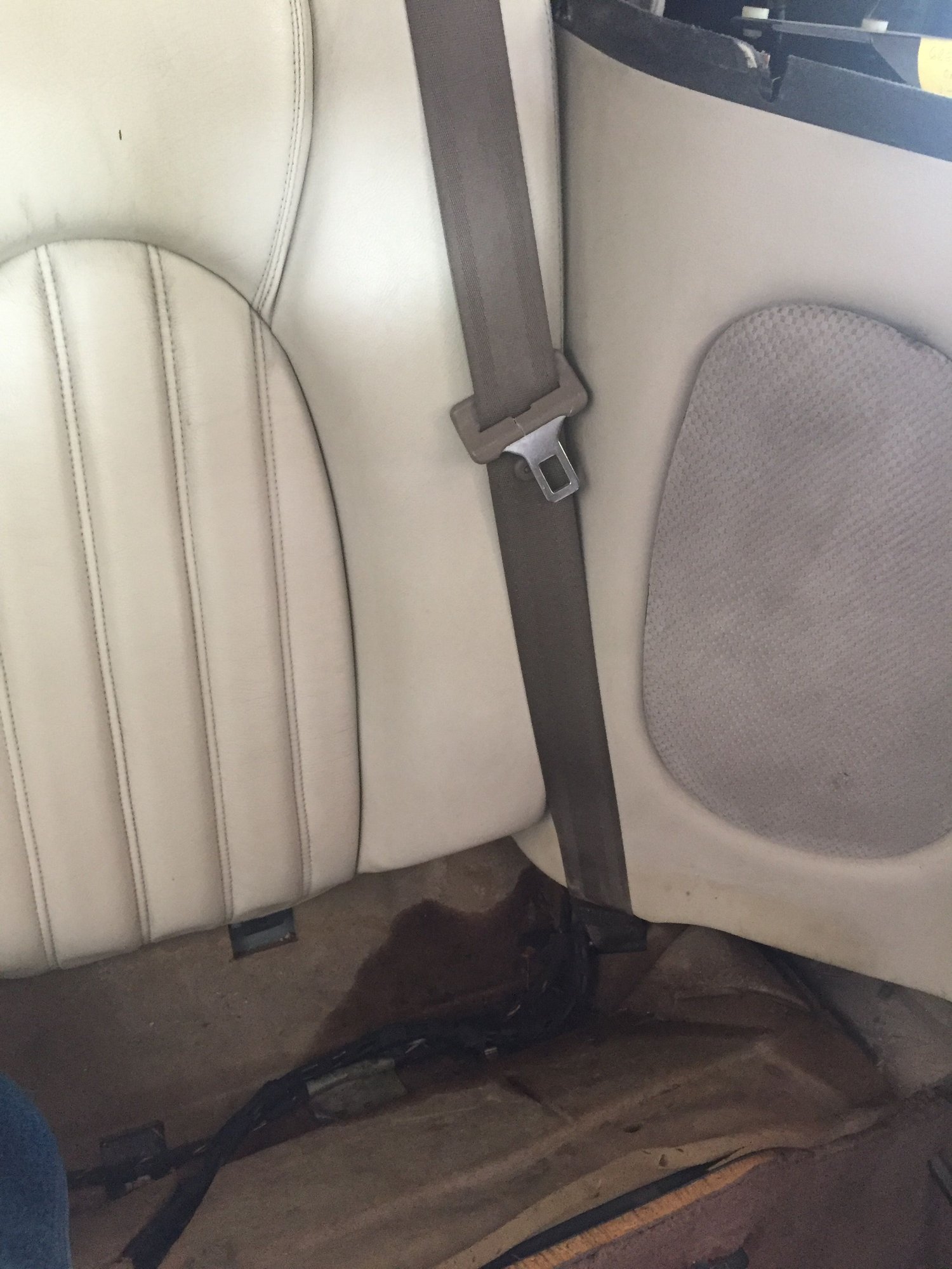

So during the pre purchase inspection I asked the shop to inspect for the green shower. I was still on Oregon negotiating with seller in Arizona.
PPI said "TOP HYDRAULICS DRY AND LEVEL GOOD"
Bought the car and took car in today for some of the recommended changes and they said I have leaky hoses as evidence by fluid in the top latch.
Shop has yet to quote the repair costs but I know it won't be cheap.

The first thing you should do is to remove the overhead console and sop up any oil in it. I'm pretty sure new ones are no longer available.
Once it's clean, you can put some paper towels in it and re install the console till you fix the hoses.

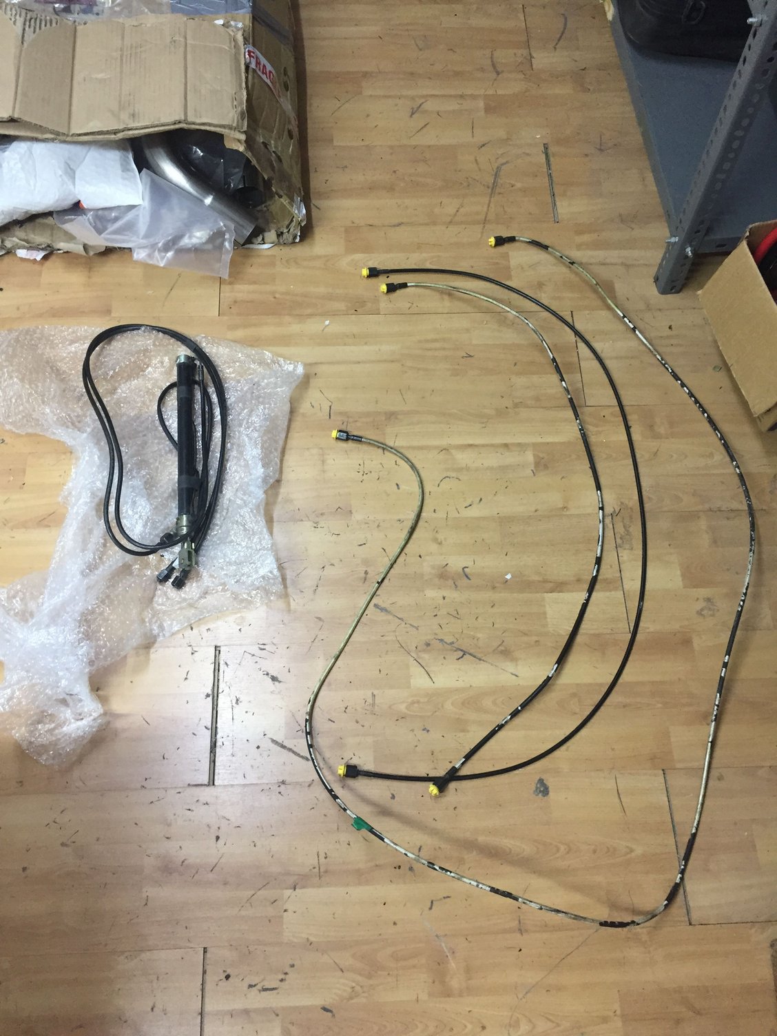

Just spent a good half hour going through my receipts book, yes I have a lot of receipts, and cannot find the original one for the hoses. However I browsed the internet and think I have found the company.
https://www.cabriolet-roof-hoses.com...let-roof-hoses $142 gone up from £120 uk to £140 UK for BOTH hoses. I dread to think what Jagaur charge for their inferior ones.
I looked to see if there is a company that does similar ones in the US and I think I have found one..
https://www.tophydraulics.com/jaguar...atch-pair.html they are more expensive than what I paid, but at least you do not have to import them.

At the high pressures that the convertible's hydraulic system runs, I think it's fair to say that there's enough evidence from owners that both the rams leak and their hoses eventually go bad especially at the crimp at the connectors. I've oil stains behind my rear quarter panels to prove it on my 99 XK8 in Bahrain.
Did the work myself DIY, with the help from this forum, and it's not very difficult …. basically stripping out the rear interior. However you should be aware of the right cylinder ram's lower connector as it could be a different fitting. See pick below.
