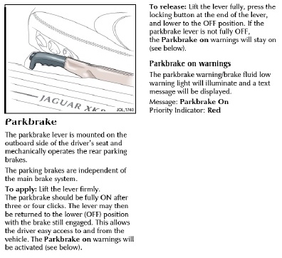

Howdy, I am a newbie. Just bought a 2002 XKR with 31000 miles. Great car ,been driving it a lot for a few weeks. No problems except finally tried the hand brake which I do not usually use. The rear brakes locked up and the brake handle is floppy. I do not have time to work on the car so I will have it towed to the mechanic. I resisted buying a Jag for years after reading all the problems so I guess I only have myself to blame.

Have you read the owners manual? I could be wrong, but, I think you pull the hand lever up and then push the button on the end and then lower it to take the brake off. At least give it a try before you have it hauled to the dealer.

Yes, I think you have a handbrake that works correctly.
It flops down so you can get out of the car easily.
You do have to pull up quite hard before pressing the button.

Are you one of the many who buy a Jaguar and then find the Driver's Handbook missing? If you need to download any of the manuals, follow this link:
https://www.jaguarforums.com/forum/x...-2003-a-67827/
Here's the Parking Brake section:
The drop down feature catches out a lot of new owners. Also, because many owners don't apply the Parking Brake very often and rely on the transmission Park pawl to hold the vehicle, they often need adjustment. ( the brake not the owner )

Thanks for those ideas, I will give it a try.

You were right, it is working correctly. Thank you for setting me straight. Maybe I won't rue the day I bought a Jag.

this thread has been a god send to me. i too have fell for the "dont need to read the manual" thing and its caught me out. i will try it tonight and have a chuckle at myself if the handbrake releases, as i'm sure it will

...whats worse, is that hopefully you haven't driven the car with the brake engaged. Then you'll really have to get dirty to tighten that cable underneath, or worse yet, change those goofy pads in the rear hubs. I did that awhile back...hated that project!

i only drove 100 yrds or so, had to go back and release via the adjuster under the car. tried releasing the handbrake in the correct way last night, and low and behold it works as it should
