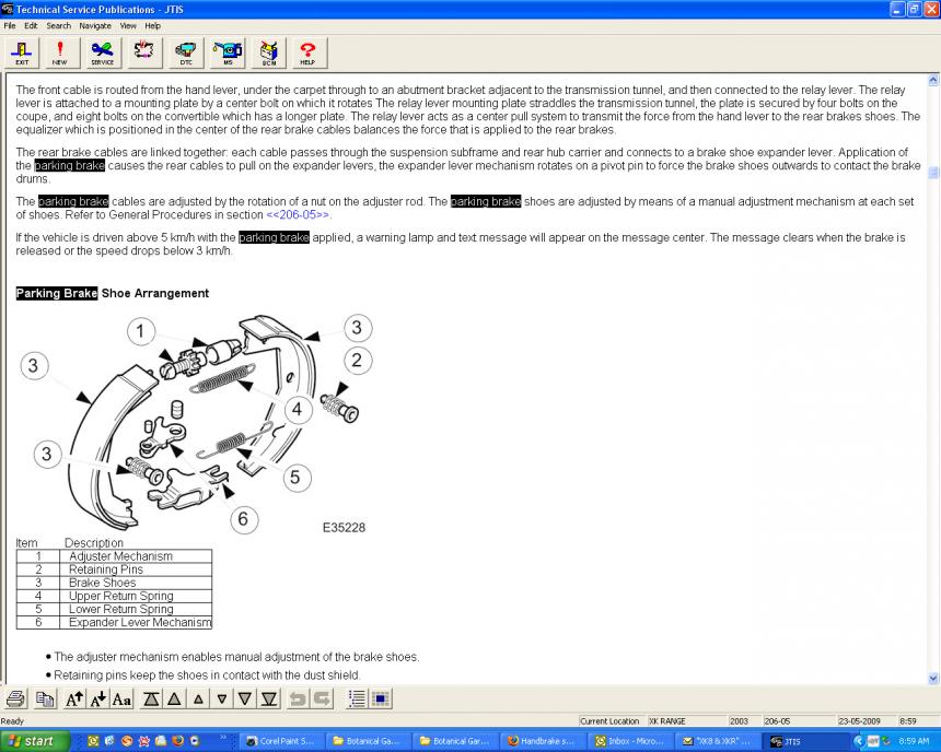

If the light is on, my guess it is engaged, although it appears only partially if you could not feel it while driving. Not sure about repair, but it shouldn't be that complex, i'd try an independent mechanic first. The parking brake assembly may need a new brake shoe if you drove it while engaged. It may have issues passing inspection if you don't. Do you have a JTIS CD that shows the parking brake assembly...let me see if mine has it. yup... enjoy!
