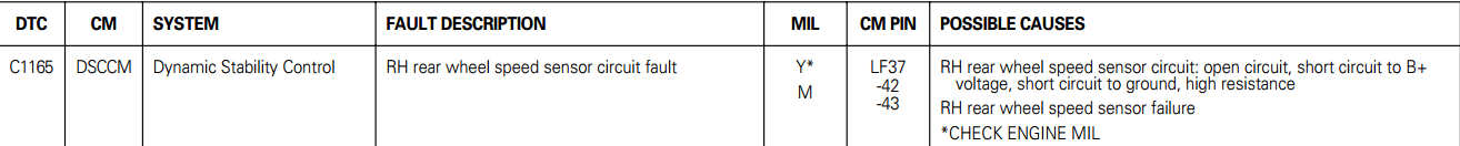

I have recently gotten a slew of lights. After scanning, the only two codes are P1000 and C1165 but the check engine, ABS, DSC Fault, no cruise control, and transmission lights all came on, as well.

Old Dec 28, 2014 | 11:11 AM
Stumpy's Avatar
Joined: Nov 2011
Posts: 581
Likes: 208
From: Devon, UK
Hello Jim
Welcome to the forum. You will find a lot of knowledgeable people on here who can help you with most things.
Have you introduced yourself in the New Member section https://www.jaguarforums.com/forum/n...-intro-must-5/
What model and year do you have ?
Is this a daily driver ? as quite often the cause of several warnings at once are caused by a low/defective battery. These cars are very sensitive to battery condition!
Many have found if the battery voltage is low they get many faults listed, a recharge/replacement has quite often cured all the lights/messages.
The Code C1165 may be a fault and is:

Yes. I thought I had put all that info in my message, I apologize. I have a 2004 XK8. It is not a gaily driver. I just bought a brand new battery from Jaguar in Atlanta (Drove 170 miles to get a genuine battery, or a battery with a genuine label, most likely!)
A Jag mechanic there told me that the Right rear wheel sensor could possibly cause the other lights to come on. I hope to heck he is correct!
