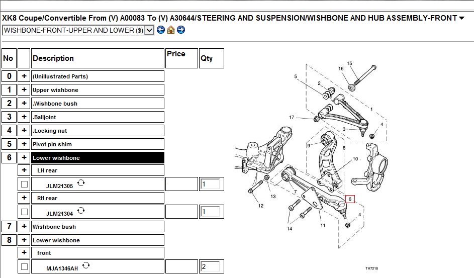

I'm sorry if I'm asking a silly question but I can't see from this pic where the camber can be adjusted as the top wishbone and lower rear appear to be fixed. Or by adjuster bolts do you mean that there is an adjustable replacement available for the lower rear arm?

It's item 12 you are looking at, these varied from the factory some were straight others were eccentric
You need to mark the position before removing just in case, but if you are taking everything apart you would need full 4 wheel alignment anyway to be sure
