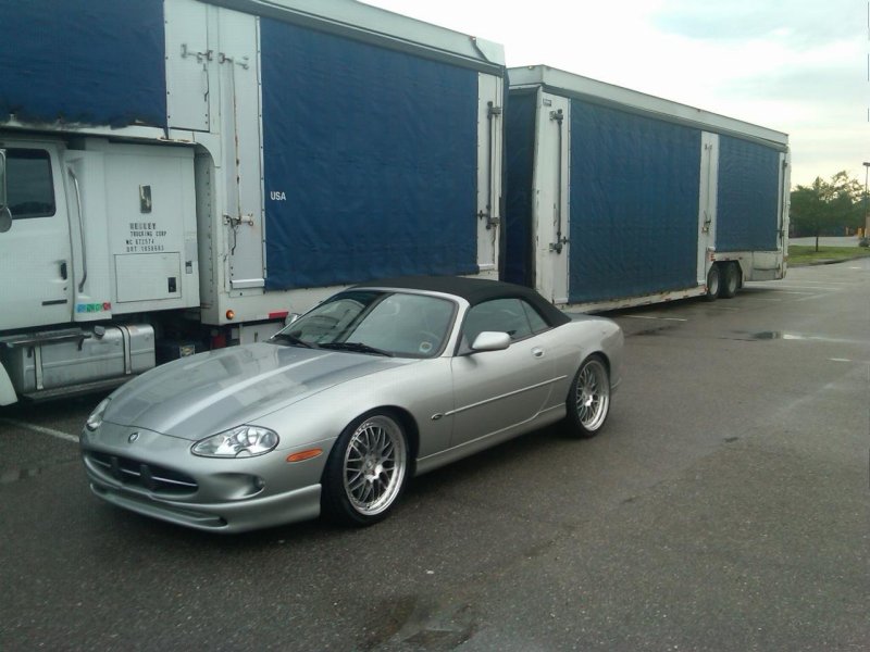

Mine is lowered 44mm. It uses the Arden springs and Arden dampers (basically relabeled bilstiens). It has a bit more negative camber than I'd prefer. Especially with the 20" Staggered HRE wheels (which all tuck tire in the fenderwell). But it's ok.
Take care,
George
Attached Thumbnails Has anyone cut their springs to alter the ride height?-16.jpg

That looks beautiful George and it's reminded me why I want to lower mine.
