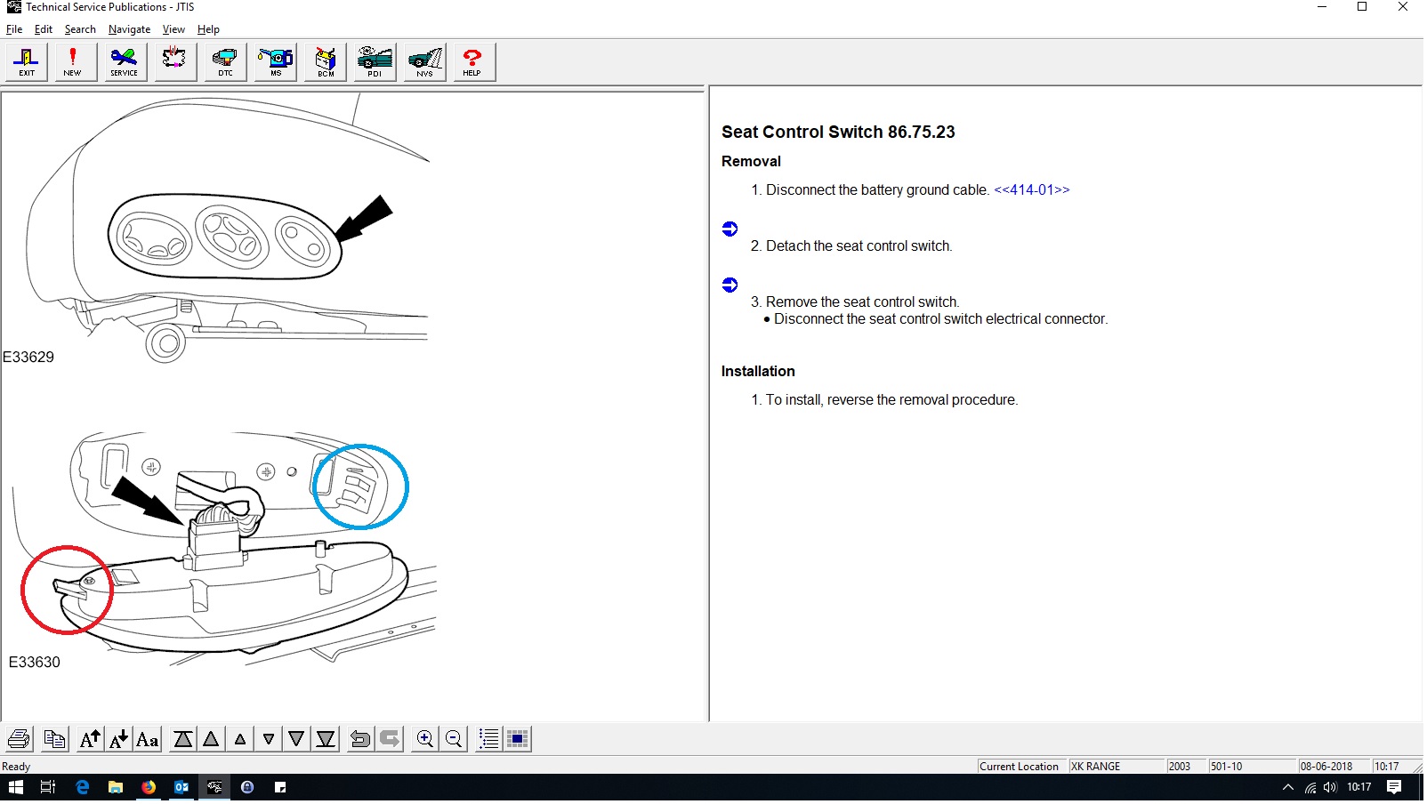

These things break if you just look at them the wrong way!
The diagrams from the Workshop Manual (LH seat illustrated) help understanding how the switchpack is secured.
(double click on the image to enlarge it)
Gently prising between the seat base and the switchpack at the point arrowed in the top diagram will release the rear of the switchpack from where it clips into the housing in the seat base (circled in blue).
The switchpack then slides rearwards to release the tab (circled in red) at the front from a slot in the housing.
