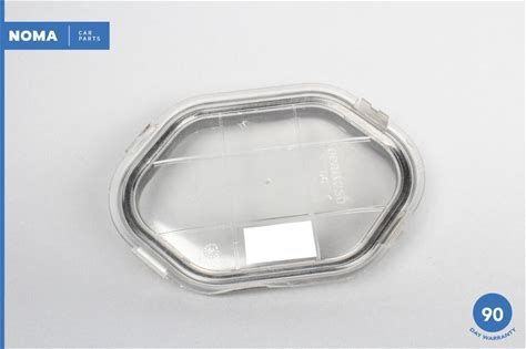

I'm sure you mean this cover:
Available from various sources. I got two new ones through Ebay for my '03 XK8 - the foam/rubber seals were collapsed and leaky.

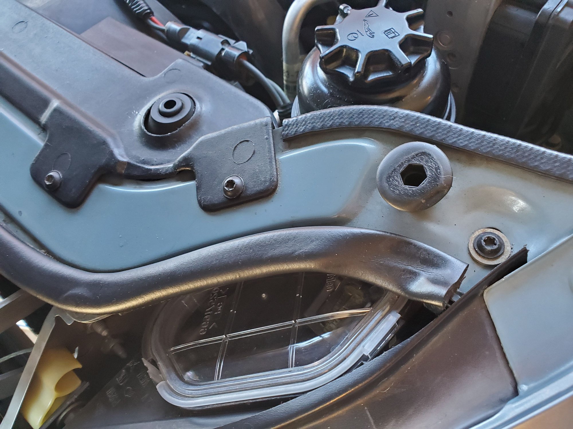

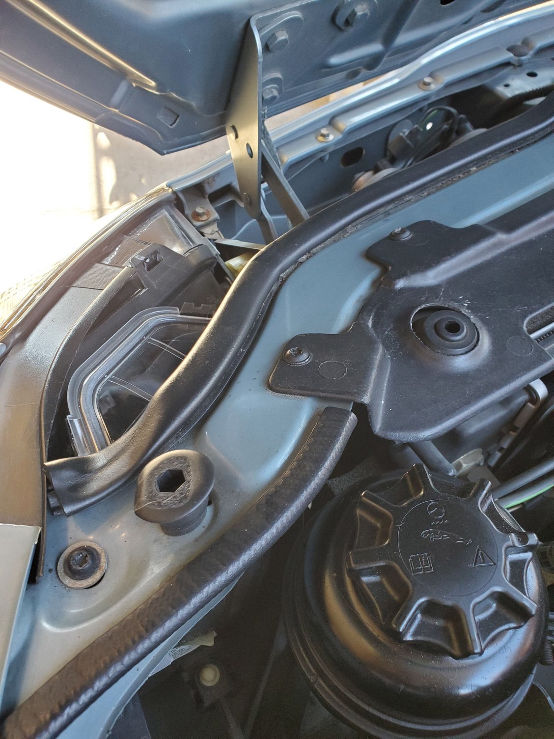

Rex - I happen to be working on another project on my XK8, so the hood is up. Here are a couple of pictures of the area you are describing. I still feel you are looking for the clear, funny-shaped cover. The black round cover on the back of the headlight housing can only be reached through an access panel on the wheel well lining.

It would be in the second picture but it looks as if yours is open between the power steering reservoir and the back of the headlamp assembly, just as is mine. Odd how the right hand side has a cover piece and not the left?

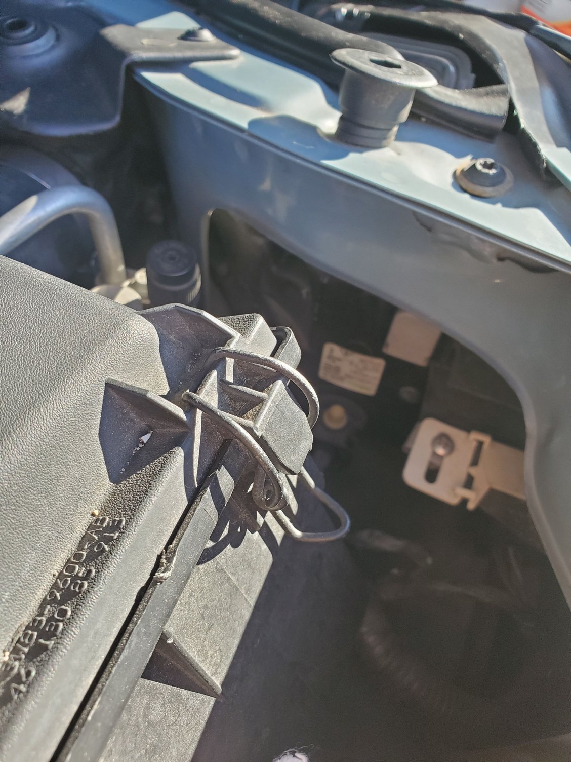

Rex - I think I see what you are looking at. They look like machined or punched out areas left and right of the radiator housing, and you can see the back and top of the headlight housings, plus headlight aiming stuff. Both of these are open on my car ('03) and it does not look like they were ever fitted with covers. Here are two pictures, left & right.

My right side is covered
