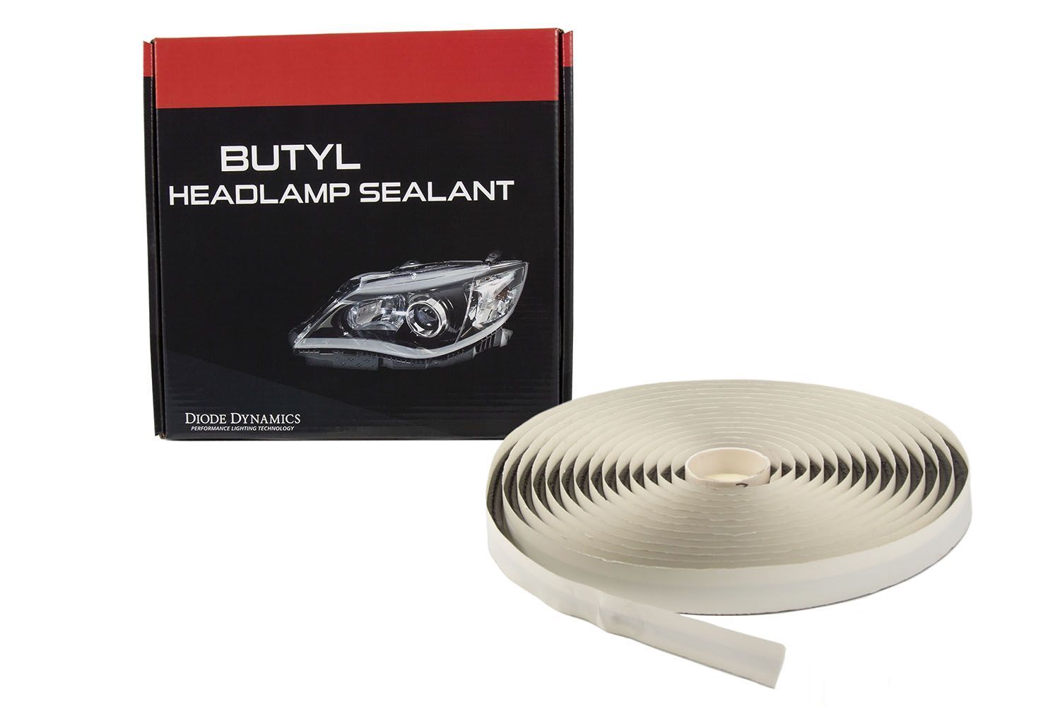

I used this stuff from Diode Dynamics, apologies for the weird image URL earlier (now fixed) - This stuff works well.
That's the type of shtuff I was talking about. Never seen it packaged just for headlights, though.
