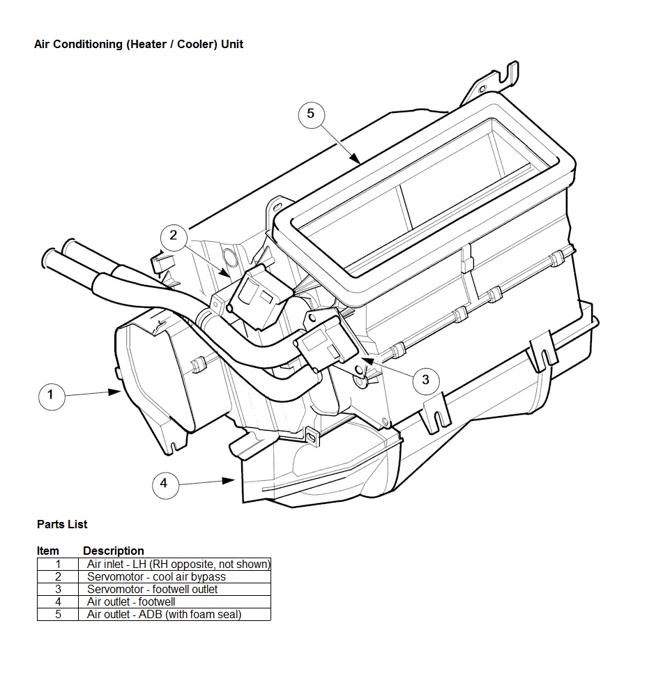

Mine does the same thing. I just turn the heater off entirely and lower the top :-)
I did notice, shortly before I noticed the heat on all the time problem, that there were some bits of foam occasionally blowing out of the vents. I suspect that there's some door deep in the heater system that had a foam seal around it which has now decomposed and is letting hot air through when it shouldn't.

Originally Posted by marcgr
........ I suspect that there's some door deep in the heater system that had a foam seal around it which has now decomposed and is letting hot air through when it shouldn't.
See Item 5:
From the difficulty of previous repairs on one of these, I think they started with the AC unit and built the vehicle around it!
