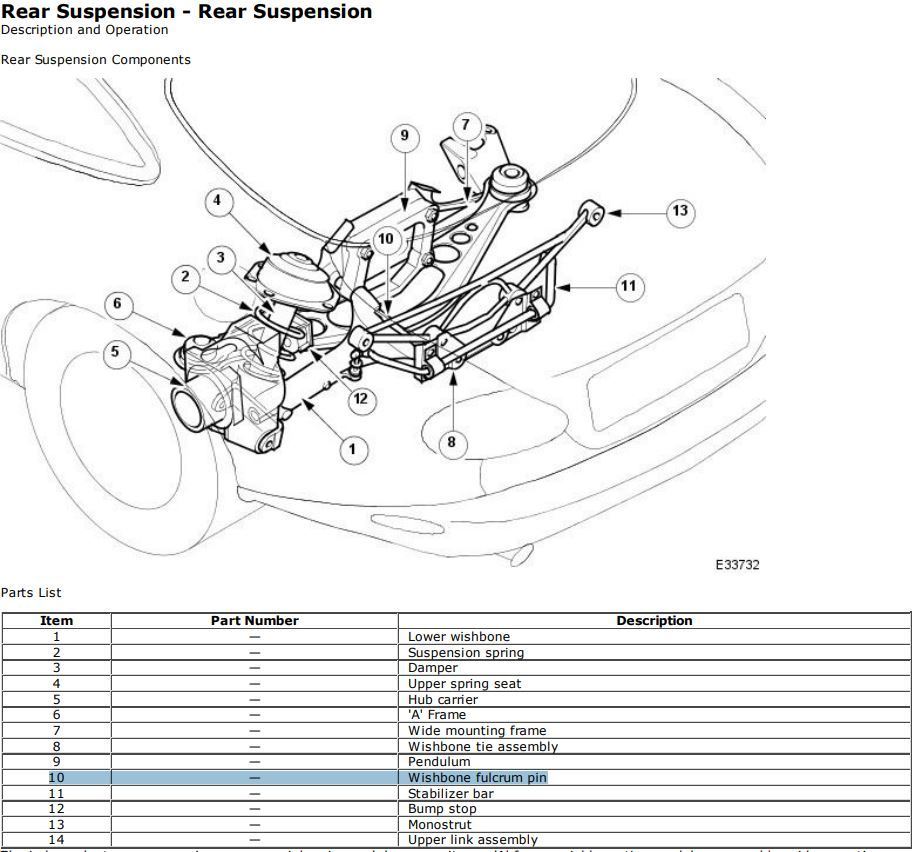

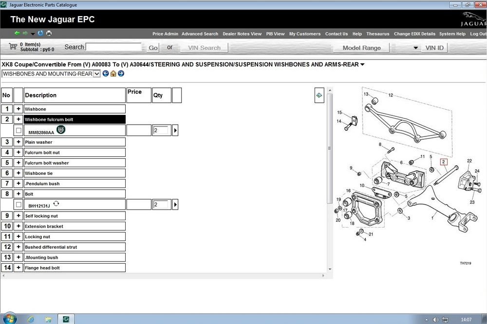

The JTIS calls that Bolt the 'Wishbone inner Fulcrum Pin'. Interestingly, it says the Nut (on the other end) should be quite tight (77-to-103 Nm). I can't remember if this Nut is tightening against a Shoulder on the Bolt, but a loose washer just doesn't sound correct to me. If you check the torque is correct (The car has to be sitting on it's wheels when you do) then all is OK.
