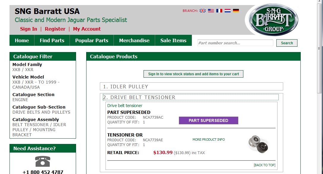

My 99 XK8 broke down on the side of the highway. Turns out out it was the belt tensioner.(Hopefully it won't be an expensive repair, my wife has been trying to get me to to sell it pretty much since I bought it) Wouldn't you know ur it, I am having a hell of a time finding a belt tensioner. Does anyone any suggestions? Where to find one, are there any parts that are interchangeable that I could get off another car that would fit on a Jaguar 4.0 V8 ? Any ideas would be appreciated.

Forum sponsor S N G Barratt list the tensioner assembly:
SNG Barratt - The Ultimate Jaguar Parts Specialist

The tensioner is easy to replace and should take 1/2 hr for the novice I did mine and used the above part.

If the tensioner still spring action and only the idler roller bearing went out you disassemble it and change just the bearing. The auto parts houses can match the bearing numbers. It isn't any harder than changing the tensioner, I did the bearing repair because of the delivery time for the new tensioner.

More than likely the spring tensioner itself is still good. You can buy a metal (instead of the original plastic) replacement pulley made by Dayton at most auto part stores.
See my post here
While your at it replace the stationary idler also as it will likely fail soon also. Do not reuse the old belt because if it has a kink in it from being thrown off it won't stay on long.
