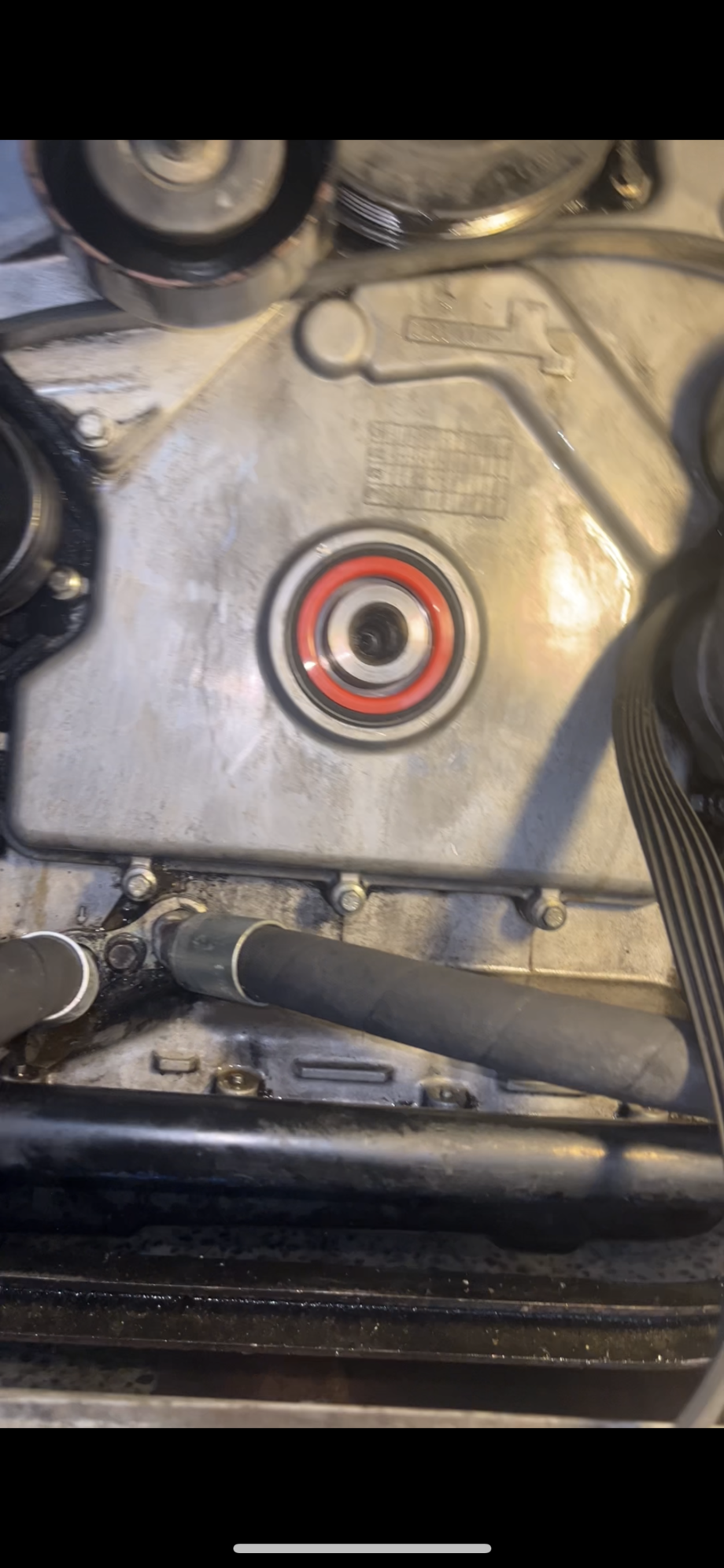

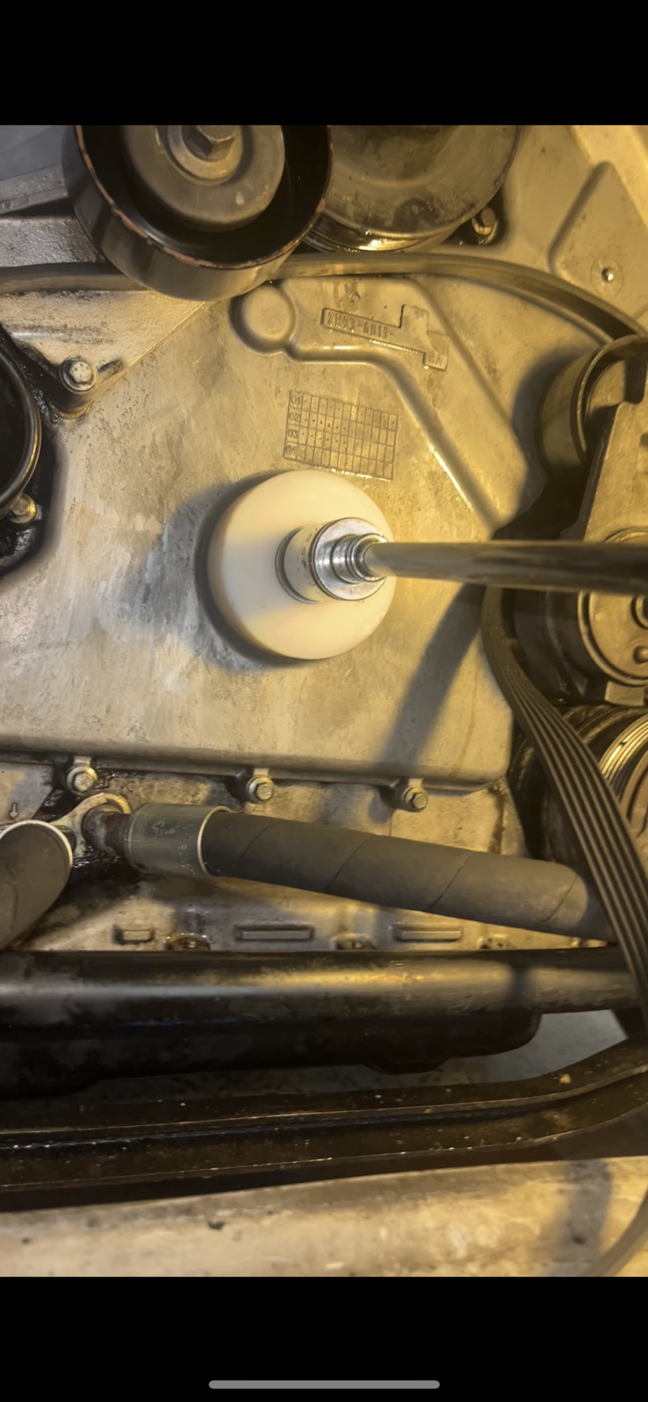

Placing the new seal
The seal is in place
Removed the red protector

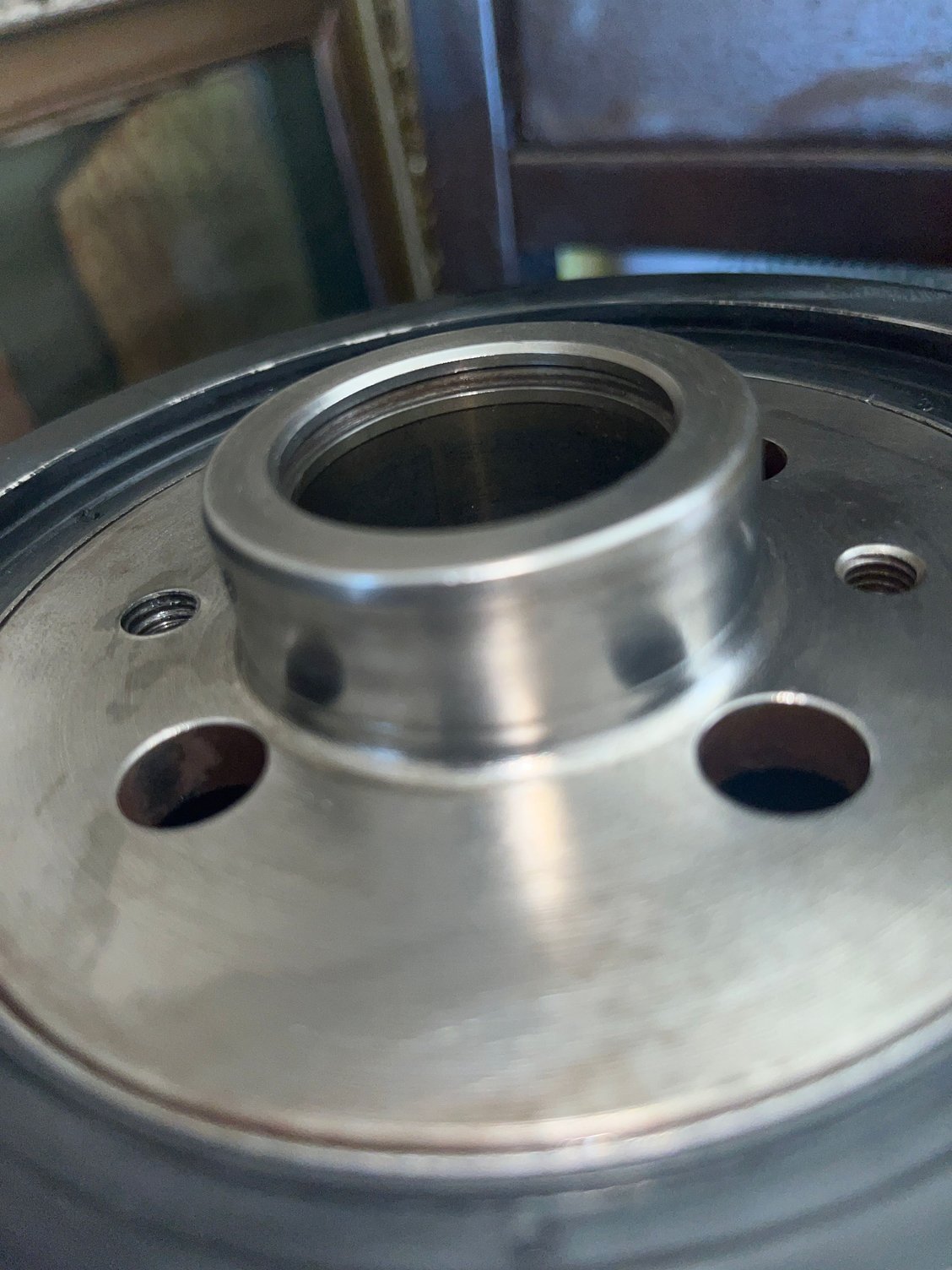

Cleaned up the mating surfaces with a wire brush.

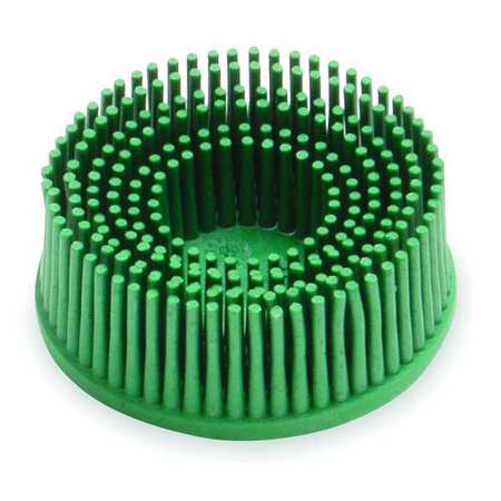

Using a wire on a seal mating surface is a risky way to prepare the parts for reassembly.
The 3-M Roto loc’s come in many different grade of hardness and will clean a metal surface with no danger of degrading the metal surface.
3M 048011-18730 3M-18730 Roloc Bristle Disc Grade-50, Size-2, Green
Available on Amazon and most parts stores
Z
Z
I had never even heard of these. I don’t think the wire wheel degraded my surfaces. There’s no pitting or scratches. I only used the wire wheel on the crankshaft damper. I did not touch the timing cover with it. The damper is made of steel.

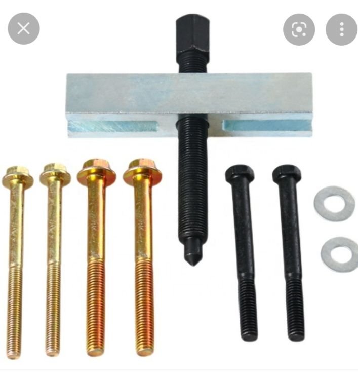

Anyways, at the end of it all, today, I just leave everything free. I don't try to "lock" the crank with pins and what have ya. I have had success with a short section of cut serpentine belt wrapped around the pulley, then over that a canvas strap that comes with the LARGEST pipe turning tool I could find online. I add a pole to the handle of the pipe turning tool to stop the crank/pulley from turning/rotating, finding that point by turning the bolt on the crankshaft until the strapped pulley and pole finds a good "catch" and hangs up. With water pump removed the handle of the pipe turning tool with it's extension would finally come up against a stop somewhere in the engine bay. From there, I remove the large 24mm bolt with a breaker and pole - not so easy to do, as it is to say it.
Then the fun part. Threading those counter force bolts into the face of the pulley itself - all knarly and somewhat corroded. The puller tool I ended up finding and like best is the one below. I set it up after dousing things with penetrant, use an appropriate sized socket between the treaded shaft of the removal tool to catch the snout of the crank without damaging the crank threads, and start tightening...
For me, the key has been to get it good and TIGHT, then tap on the face of the pulley wheel with a plastic mallet - then LEAVE it. Come back, tighten some more - tap, tap, tapppp.... Leave it. Come back, tighten and tap. Time between tightening and tapping was the key for me. Eventually it just slides off. Resist thinking a pry bar will help. Ask me how I know. OMG.
I do NOT envy the wrencher that runs into a seized up pulley wheel. It's definitely not for the faint of heart.
