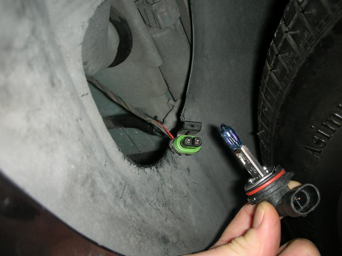

I used carhidkits.com BUT this really only works for the Low beams as a plug and play kit, even tho the Fog lights are the same lights.... I specified Fog but they have a diff connector and would need to be spliced (my fogs are sitting in my garage still) . The high beams are Dif from the Low and Fogs. I never looked at them.
The pic was the pic I sent the company to explain how these fog connectors were diff. They said they didn't make them so I'm waiting to splice them in, I don't think to hard though. The Fogs are easier to get to then the Low/main beams.
be sure to search fourm there is a lot of people who have done this mod.
This was done on my 1999 XK8 and i love the look. 2002 could be diff. I went with the whitest color.
